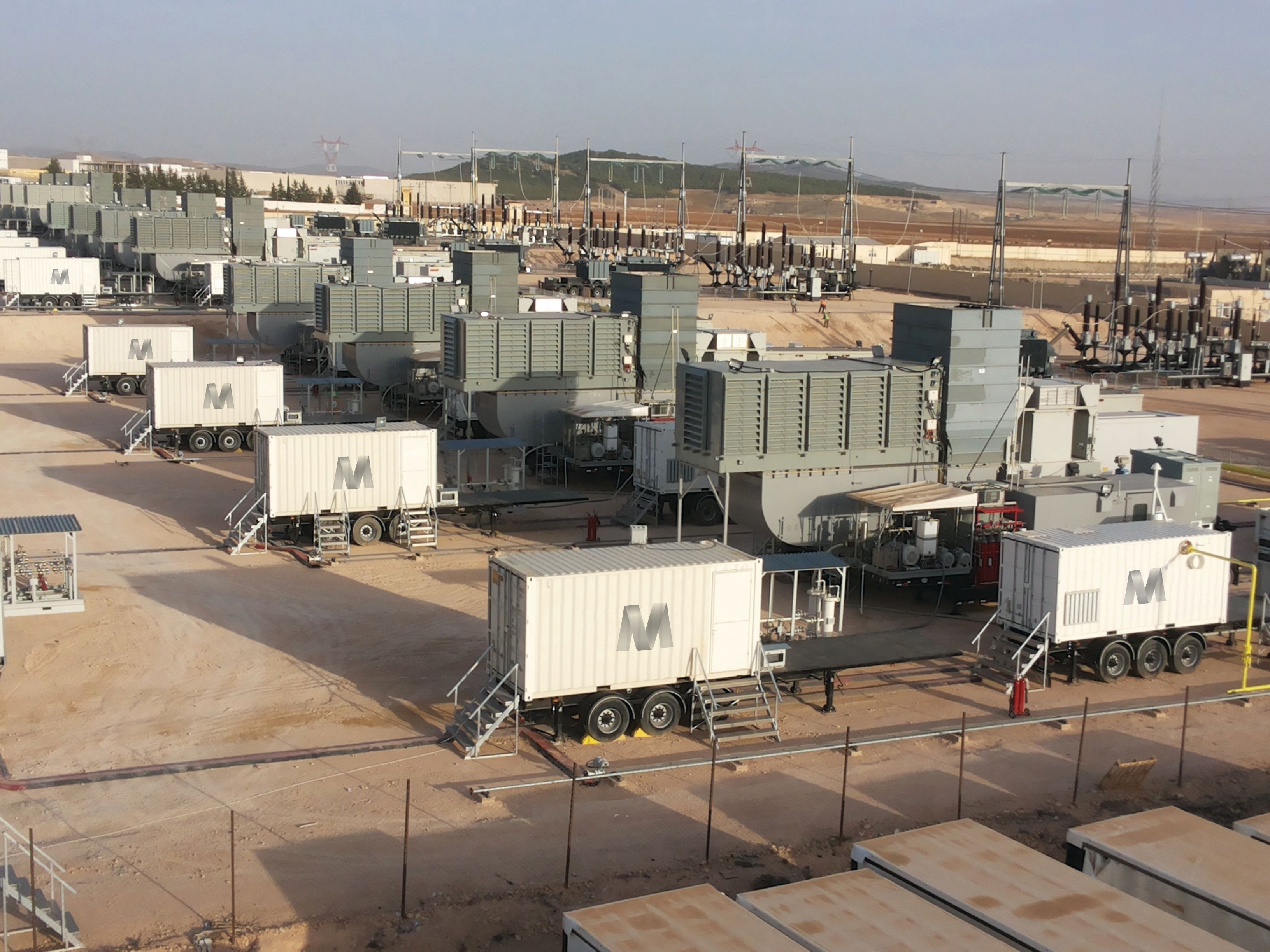

Mytilineos uses fully portable MPUs with aeroderivative gas turbine technology that can run up to 35 MW per unit.
“We specialize in creating customized designs for gas mobile MPUs in collaboration with OEMs. Our approach involves utilizing a range of modular accessories to complete the design process quickly and safely, typically within a few months”, said Horinos. This customization extends to the ancillary and auxiliary equipment for the mobile packages, including the main gas turbine trailer, auxiliary turbine trailer, high voltage (HV) substation trailer, electrical auxiliary trailer, and more.
Remote Areas with Critical Power Needs
The company can also tailor MPU sets to tackle specific issues.For example, in Takoradi, Ghana, Mytilineos delivered 10 GE TM2500+ mobile gas turbine power packages and full operation and maintenance services, including trailer-mounted balance of plant equipment.
In Algeria, Mytilineos installed and commissioned 38 mobile gas turbine power generating sets with a total output of 775 MW attained at local ambient conditions. Ninety-seven percent of Algeria’s generating capacity relies on natural gas-fired plants, which equates to about 68 billion kilowatt hours (kWh) per year. With renewables a far way off, the country depends on mobile power to supplement the grid during peak periods.
