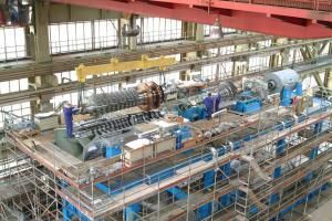

Usually, turbomachines show satisfactory vibration levels during test runs at the manufacturer’s shop. However, vibration levels after the commissioning could be higher than desirable levels. Too often, after several months of operation, vibration could show some increasing trends. This is the usual story of many turbomachines.
The lightly-loaded rotor assemblies in turbomachines could present some high vibrations. The reasons behind high vibrations of turbomachines are discussed.

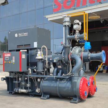

The case study is about a high vibration incident in a low-pressure (LP) overhung-impeller compressor. After one month of operation, it was reported that the vibration amplitude of the shaft, particularly on the inboard bearing (the bearing near the coupling) passed alarm limits and approached to a trip set point. The compressor train had tripped because of high vibrations. Inspections after the trip showed some seal and vibration damages. The reason of the failure was an improper coupling selection.
A high angular stiffness coupling (a strong metallic disk coupling) was initially used which resulted in a very high loading on the bearing and seal combined with a misalignment; all these caused damages to these sensitive components. To solve the issue, the following corrective actions were taken simultaneously:
1-      A suitable coupling with a lower angular stiffness was selected (a sophisticated diaphragm-type coupling).
2-      A comprehensive rotordynamics analysis, considering coupling effects, was performed. This study confirmed the suitability of new coupling and predicted low vibrations.
3-      Proper alignment limits were specified and controlled.
By these modifications, the compressor showed a satisfactory operation and a low operating vibration.
