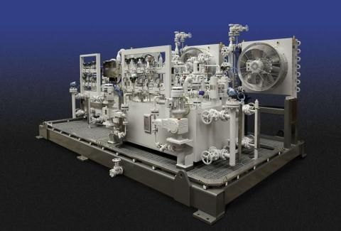

One of the most important pre-start-up operations for an auxiliary system is flushing. The object of flushing is to render the entire auxiliary system free of excessive particles that could enter into critical equipment components, thus causing significant equipment damage.
To ensure efficient field flushing preparation, understanding of the entire system and monitoring of flushing operations is required. A schematic showing the entire auxiliary system must be reviewed prior to establishing the flushing procedure.
Each system will include an auxiliary system console, inter-connecting piping, unit piping, and drain piping. In the case of liquid seal systems, drain side components will also be included (automatic seal oil drainers degassing tanks, etc.). Review of the specific system is essential to determine the location of flushing screens and sequence of the flushing operation.
