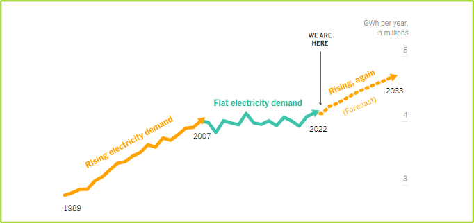

Gas turbines, used for renewable energy backup and behind-the-fence power generation, parallel the growth in electricity demand (Fig. 1). Catalysts for the load upswing in the U.S. include investments in dispatchable backup power to support renewable energy and behind-the-fence generation to fill electricity demand from Artificial Intelligence (AI), and the Inflation Reduction Act’s boost to manufacturing and infrastructure.
The energy and utilities sector (E&U) in the U.S. deploys approximately 1,000 peaker plants, mostly gas-fired aero-derivatives. Another 38 Gigawatts (GW) of peak demand additions are projected over the next five years. To meet this demand, Georgia, North Carolina, South Carolina, Virginia, Tennessee, and Texas, among other states, propose building multiple gas-fired peaker plants1. In conjunction, an estimated 290 TWh of electricity will be needed in 2030 to meet demand just from data centers and EVs, on top of which is an additional 9 percent rise in demand from industry. Some of this electrical growth will need to be supported by gas-fired generation, whether as peakers or islanded power2. All these new gas-fired units operating in simple cycle will need hot SCR technology.

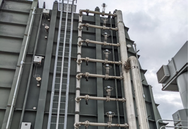

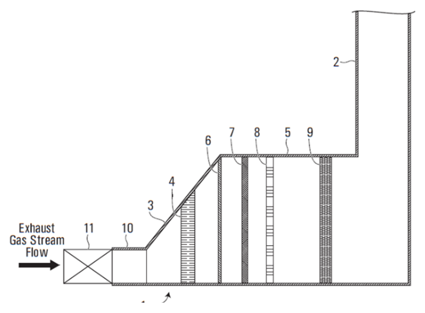

In the Conventional SCR system, ammonia is vaporized using an electric heater or recirculated exhaust gas in an external ammonia vaporization skid (AVS), and enters the turbine exhaust through the ammonia injection grid (AIG).Several hundred conventional SCR systems have been installed worldwide over 20 to 30 years.

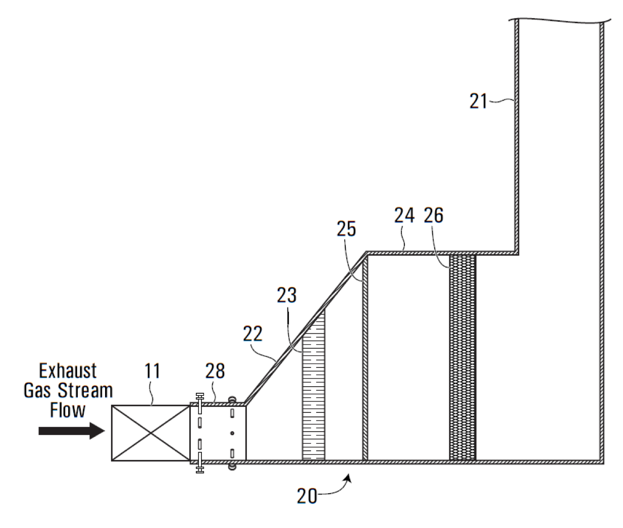

In EnergyLink’s Direct Injection system, liquid ammonia is injected into the turbine exhaust stream using multiple retractable air-cooled injection nozzles at the Direct Injection Duct (Fig.3, 28), so that the radial distance from the casing and the axial distance from the turbine can be varied.The conventional AVS and AIG were installed as backups and were not used during the direct injection system tests.A dual SCR/CO catalyst (Fig. 3, 26) was used in EnergyLink’s Direct Injection system, which, according to EnergyLink’s knowledge, is the first dual catalyst installation of its kind in the world.

EnergyLink’s Direct Injection system injects the reducing agent into the exhaust gas stream as a liquid rather than a heated gas right at the Turbine Exhaust Gas Inlet Duct entrance (Fig. 3, 28). Cooling air and reducing agent liquids are fed into injectors via separate supply lines. This configuration contrasts with a conventional SCR system, where the exhaust gas stream must travel through the inlet duct to reduce its velocity and also be cooled within the expansion duct to produce a temperature ideal for catalyst bed(s) performance -800 to 900 °F.
In systems with an exhaust gas stream at temperatures higher than 900 °F, introducing cooled air as a mixture of ambient air and exhaust gas via a tempering air injection system reduces the exhaust gas stream temperature to an effective range. After reducing the velocity and, if necessary, the temperature of the exhaust gas stream, the stream passes through a distribution grid at or near the entrance of the horizontal duct. The distribution grid spreads the flow of the exhaust gas stream evenly across the cross-section of the horizontal duct.
In EnergyLink’s Direct Injection system, components such as the reducing agent vaporization system, heaters, blowers, ducting, injection grid, and associated pipes and valves are unnecessary (Fig. 5). Reducing these components and the footprint of the SCR system will result in a material reduction in capital and installation costs.Without a large ammonia vaporization fan, parasitic loads and operating costs are also reduced.

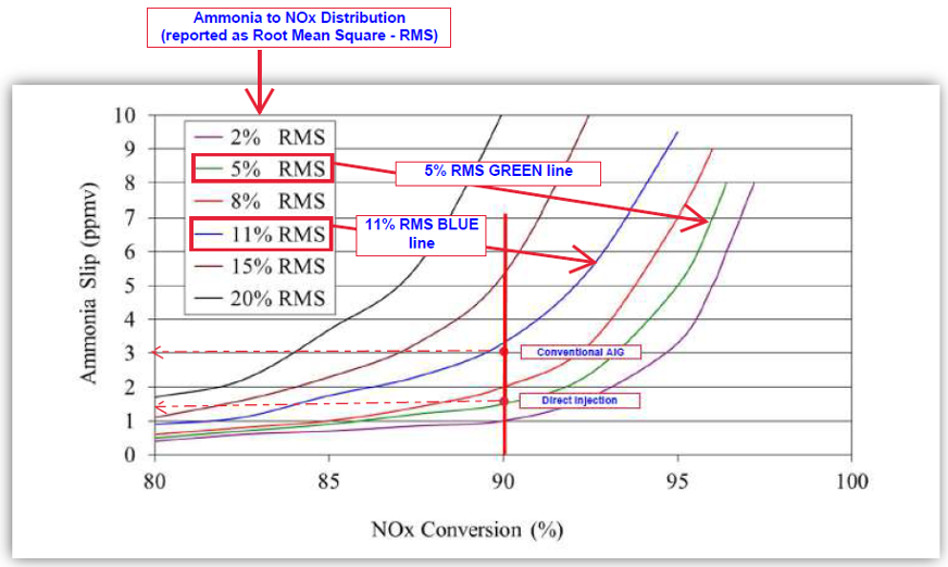

PERCENT (%) ROOT MEAN SQUARE (RMS) EXPLAINED
Root mean squared (%RMS) is a statistic that quantifies the variability in the inlet ammonia-to-NOx distribution, with a lower %RMS indicating a more uniform distribution.
A chart by Haldor Topsoe provides a series of reducing agent-to-NOx %RMS lines for an SCR system for a turbine operating at full load using ammonia as the reducing agent.The vertical axis lists the target amount of ammonia slip in parts per million (“ppm”), and the horizontal axis lists the target percent of NOx removal.
If the design parameters for the SCR system are to have, at full load conditions, no greater than 4 ppm slip of ammonia with at least a 92% removal of the NOx, the chart illustrates that the %RMS of the ammonia-to-NOx distribution at the inlet of the catalyst bed must be no more than 7%.In summary, the lower (or higher) the amount of ammonia slip required, at a given percentage of NOx removal, the lower (or higher) the %RMS of the ammonia-to-NOx distribution.

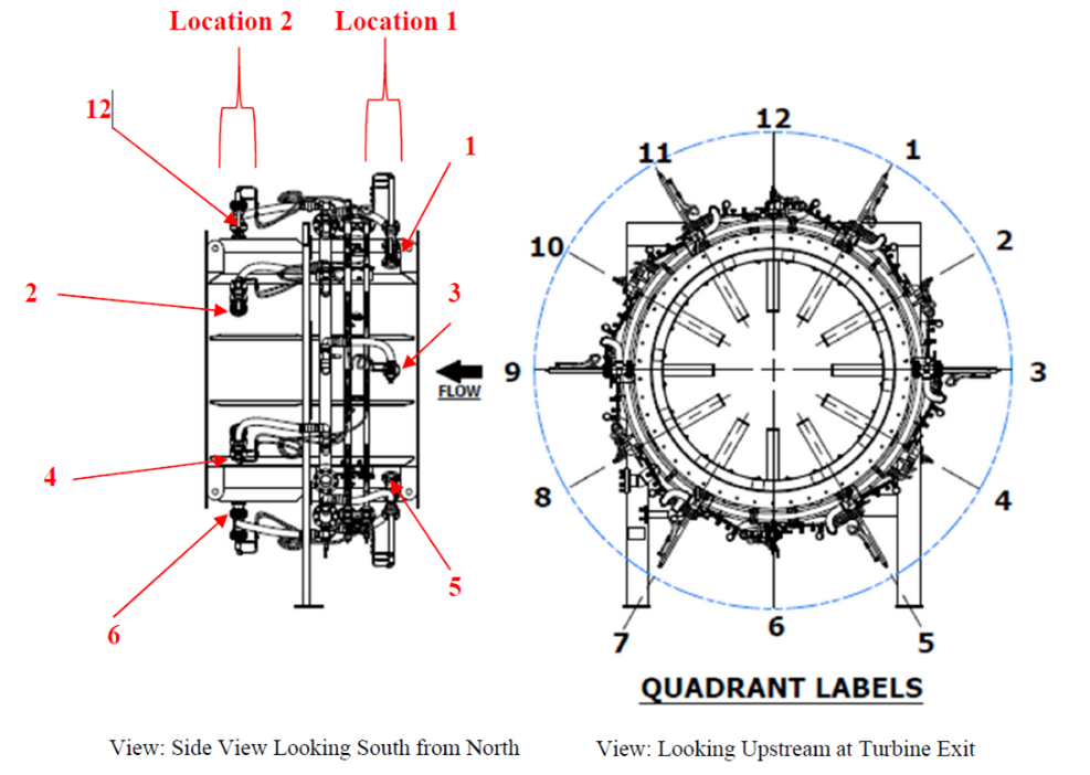

In the full-scale Direct Injection system, two (2) sets of six injection lances are spaced around the circumference of the inlet duct, designated Location 1 (upstream) and Location 2 (downstream) (Fig. 6).
At each location, lances are spaced 60 degrees apart. Between Locations 1 and 2, lances are
staggered 30 degrees apart, forming a wall clock pattern when looking down the circular duct. Lances are numbered accordingly, with the lance on the top being Lance #12, and the lance on the bottom being Lance #6. Location 1 has odd-numbered lances, and Location 2 has even-numbered lances (Fig. 6).
Fig. 6. Example of Direct Injection Lance Schematics of Test Rig Unit
Direct injection “tuning” is performed by adjusting the number and location of lances in use, ammonia flow rates to the lances, and lance positions (fully inserted, half extended, fully extended, or any position in between) to settle on a configuration that results in the best SCR system performance and ammonia-to-NOx distribution.
