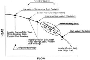

How centrifugal pumps respond to process requirements
Centrifugal pump component damage and causes as a function of
operating point[/caption]

The differential pressure required by the process can be changed by adjusting a control valve in the discharge line. Any of the following process variables (P.V.) shown can be controlled: Level, pressure, flow. Changing the head required by the process (differential pressure divided by specific gravity), will change the flow rate of any centrifugal pump. All types of mechanical failures can occur based on where the pump is operating based on the process requirements.
Since greater than 95% of the pumps used in this refinery are centrifugal, their operating flow will be affected by the process. Centrifugal pump reliability and flow rate is affected by process system changes. Increased differential pressure (P2 — P1) means reduced flow rate and decreased differential pressure (P2 — P1) means increased flow rate for a centrifugal pump.
