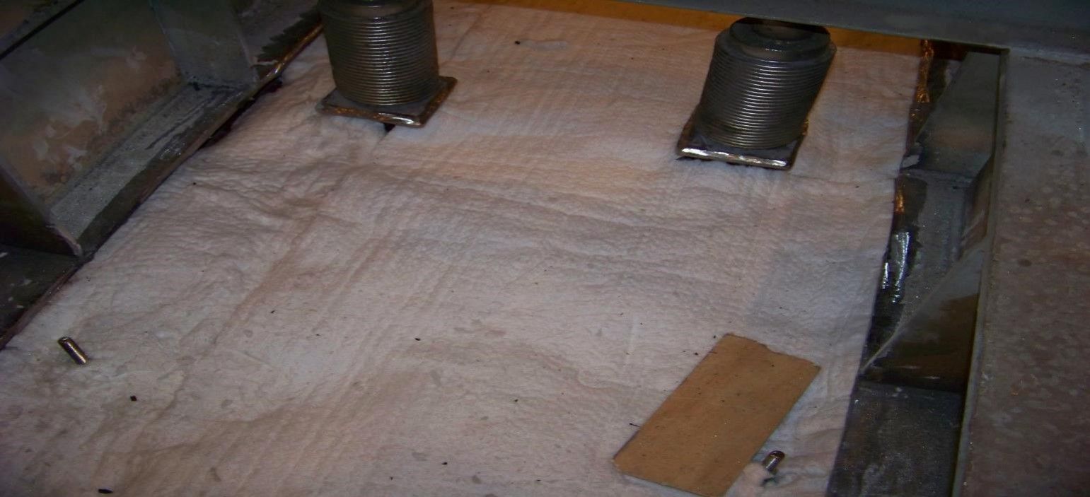

Each duct liner consists of three major components:
  • Thermal insulation (ceramic fiber), where the insulation thickness is calculated from the exhaust gas temperature and the required temperature of the outer duct plate.
  • Studs or scallop plates for insulation and liner sheet attachment and support.
  • Liner sheets protect the insulation (FIGURE 1) from the combustion turbine exhaust gas flow.

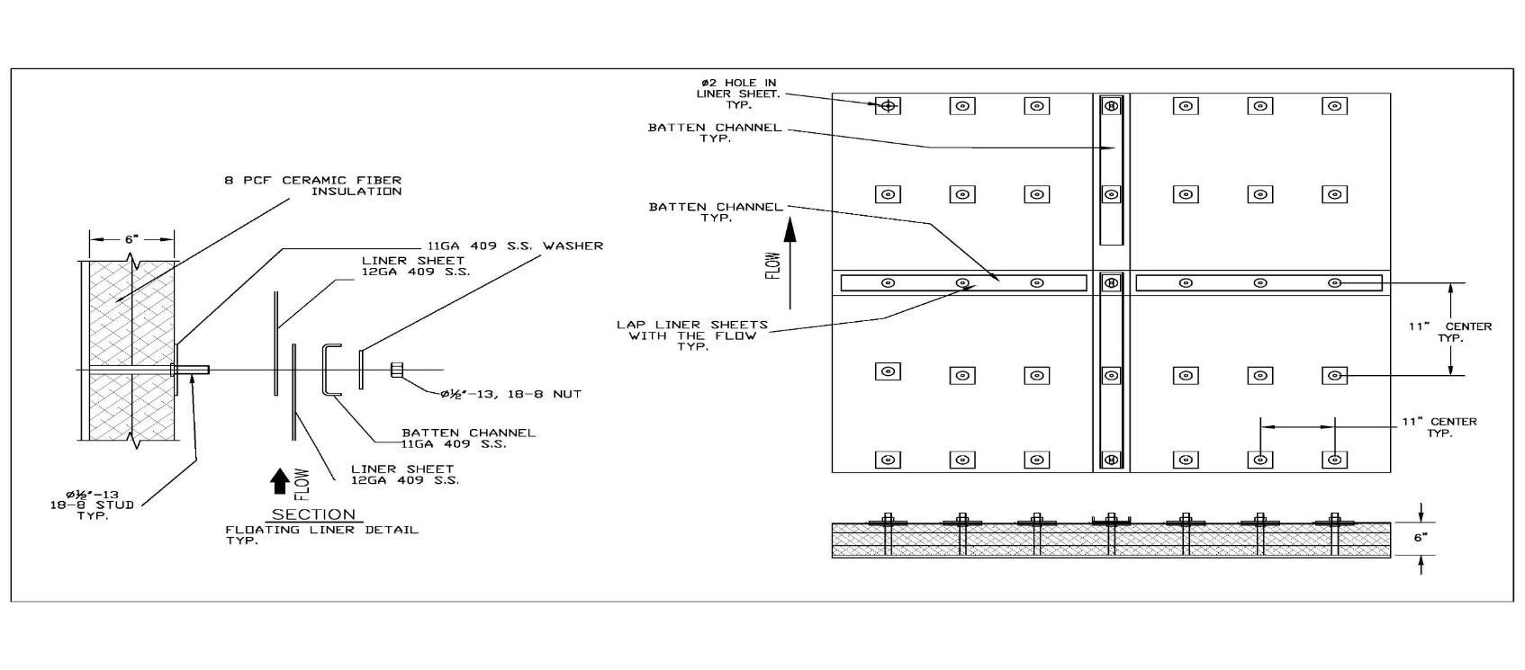

Ceramic fiber is a highly efficient insulating material. Additional items that require careful evaluation and installation are mounting/support brackets for the insulation and internal liner sheets that protect the insulation from the dynamic environment. Floating liners have the strength to withstand the flue gas flow and can thermally expand without constraint (FIGURE 2).

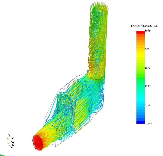

These details can be determined by both past experiences and analysis tools such as computational fluid dynamics (CFD).
CFD data helps to pinpoint locations of maximum flow, which in turn may require adjustments to design parameters that are otherwise acceptable for other locations in the system.

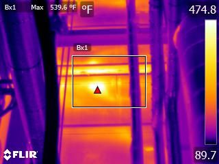

To improve performance and repair damaged equipment, inspect existing systems and make modifications accordingly. A first step is often thermal imaging of the duct from all sides. Thermal images (FIGURE 4) are then utilized to install or repair insulation at “weak” locations. These weak spots may come as a result of equipment degradation over time from the harsh environment.

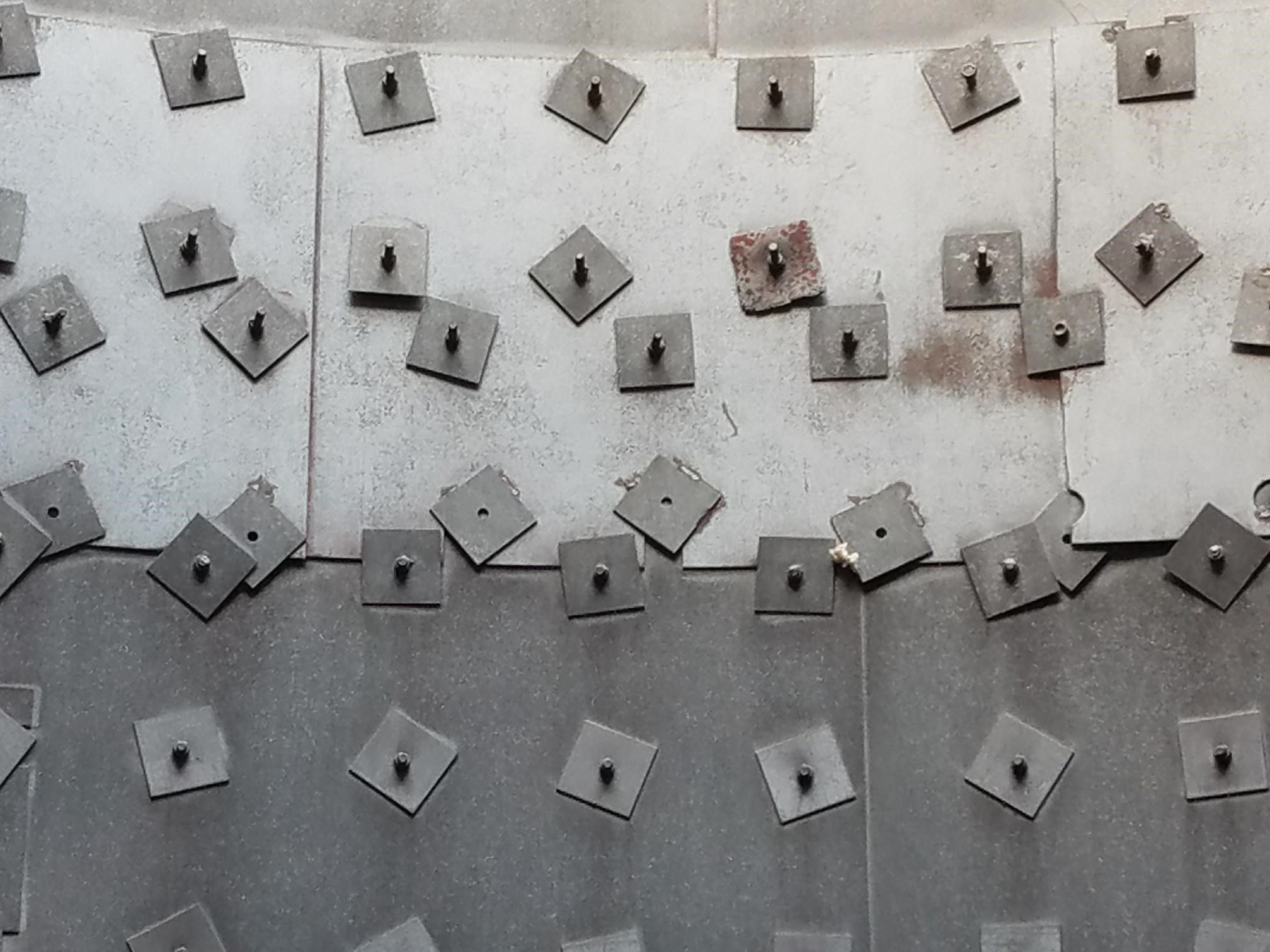

Another issue could be the result of poor equipment installation. FIGURE 2 illustrates a precise pattern for stud location. Compare that with FIGURE 5 below from an existing unit.

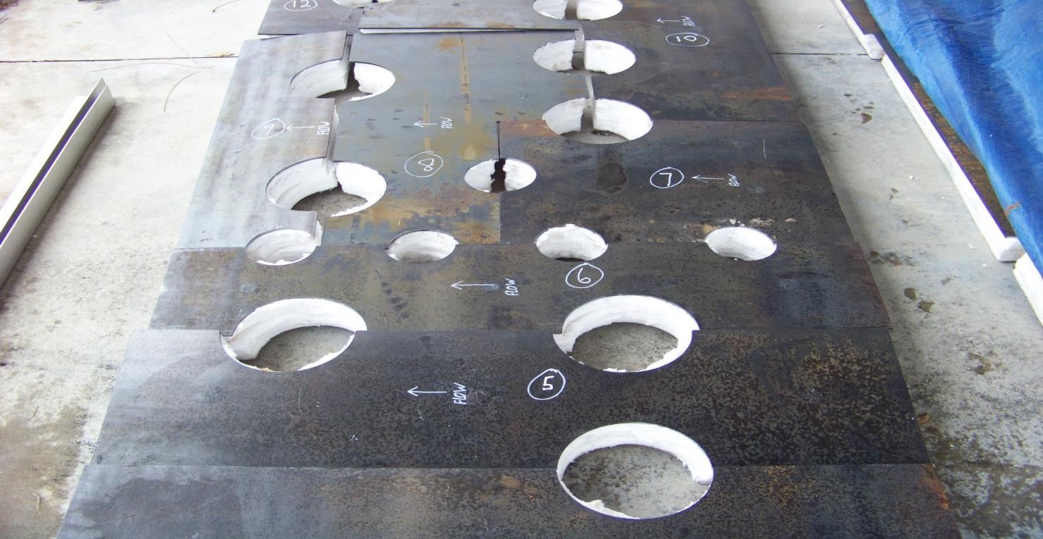

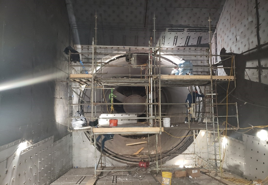

It does not seem that much if any science was utilized in this pattern. The welding techniques appear to be haphazard as well. Welding is an extremely critical issue for many industrial equipment items. Welds are often prime locations for induced stress if not performed properly and with the correct filler materials. Conversely, FIGURE 6 illustrates the precise stud alignment in a relining project. It may be possible to prefabricate some sections to lower project or repair costs (FIGURE 7).
