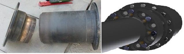

Within the coupling, it is possible to incorporate a number of devices to overcome the potential damage caused by a torque overload. The most common is to incorporate a mechanical shear device, either as a single spool piece, commonly referred to as a shear spacer or shear pins which have a reduced section groove on a common pitch circle. In the event of a torque overload, the reduced section groove(s) will shear, disconnecting the turbine from the driven equipment.

A shear spacer design consists of a single spool piece with reduced section groove of a calculated diameter determined to shear at a given torque. In order to maintain alignment, stop flailing of the two sheared sections and allow run-down in a controlled manner, a bearing is included. The design of this run-down bearing can differ in design with either a plain bearing manufactured from a brass material or dynamic ball or roller bearings being used.
A shear pin arrangement consists of a series of pins located in 2 flanges, the pins having a calculated groove diameter, positioned on a common pitch circle. A bearing is included to control rotation after disconnection.
