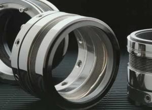

To ensure reliable, trouble-free operation for extended periods of time, the seal must operate in a properly controlled environment. This requires that the seal be installed correctly, so that the seal faces maintain perfect contact and alignment, and that proper lubrication and cooling be provided. A typical seal system for a simple, single, mechanical seal is comprised of the seal, stuffing box throat bushing, liquid flush system, auxiliary seal and auxiliary flush or barrier fluid (when required).
The purpose of the seal is to prevent leakage of pumped product from escaping to the atmosphere. The liquid flush (normally pumped product from the discharge) is injected into the seal chamber to provide lubrication and cooling. An auxiliary seal is sometimes fitted to the gland plate on the atmospheric side of the seal chamber. Its purpose is to create a secondary containment chamber, when handling flammable or toxic fluids that would be considered a safety hazard to personnel if they were to leak to atmosphere. A liquid (non-toxic) flush or barrier fluid, complete with a liquid reservoir and appropriate alarm devices can be used to ensure toxic fluid does not escape to the atmosphere.

An indication of some causes of seal failures can be obtained while the seal is operating. When you consider the seal as an equivalent orifice, an examination of ‘tell tale’ symptoms can indicate causes of potential failure for which corrective action can be implemented or at least can provide direction of subsequent failure analysis. It should be noted that improper application, installation, and/or manufacturing errors can also result in mechanical seal failures.
Possible causes of seal failure
  • Seal squeal during operation
            Possible causes – Insufficient amount of liquid to lubricate seal faces
Recommendations – Flush line may need to be enlarged and/or orifice size may need to be increased.
  • Carbon dust accumulating on outside of seal
Possible causes – Insufficient amount of liquid to lubricate seal faces, liquid film vaporizing/flushing between seal faces.
Recommendations – Pressure in seal chamber may be too low for seal type
  • Seal splits and splutters in operation (popping)
            Possible causes – Product vaporizing/flashing across seal faces
            Corrective action is to provide proper liquid environment of the product at all times:
1.      Increase seal chamber pressure if it can be achieved within operating parameters (maintain at a minimum of 175kPa (25psig) above suction pressure)
2.      Check for proper seal balance with manufacturer
3.      Change seal design to one not requiring as much product temperature margin
4.      Seal flush line and/or orifice may have to be enlarged
5.      Increase cooling of seal faces
Note: A review of seal balance requires accurate measurement of seal chamber pressure, temperature and product sample for vapor pressure determination.
