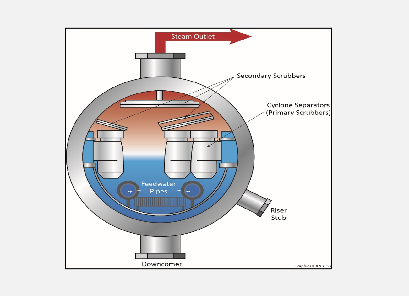

High-purity makeup water is a standard requirement for steam generators with turbines, which includes combined-cycle units with their attendant heat recovery steam generators (HRSGs). Impurities will cycle up to some extent in boiler drums. The compounds are introduced to steam through carryover of moisture. Almost all steam drums are equipped with separating devices to remove entrained water droplets (FIGURE 1).

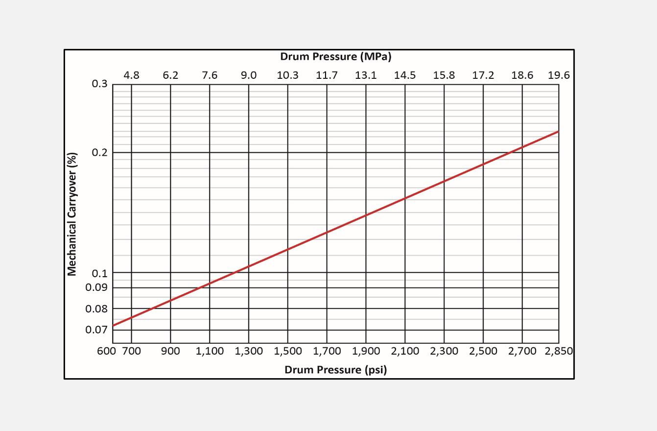

Perfect separation does not exist, and a small amount of moisture will escape with the steam. Furthermore, at higher boiler pressures, the density difference between the boiler water and steam decreases, which lowers separator efficiency as shown in FIGURE 2.
Periodic boiler water and saturated steam sodium sampling are recommended.2,3 A comparison of the two measurements from samples taken concurrently will provide a reasonable calculation of mechanical carryover.
Mechanical wear and stress also influence separator performance, and a sudden component failure can allow significant moisture ingress to steam. Steam separators and other drum internals should be part of every scheduled maintenance inspection, with maintenance procedures in place to repair damaged equipment.
