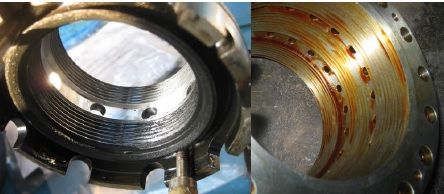

Labyrinth seals are the simplest seals ( multiple orifices)
• Low pressures
• Could be made of generally of softer material to prevent damage to rotor. non metallic materials such as PEEK gaining popularity.
• Bearing housing seals and separation seals in dry gas seals are another commonly seen applications.
• In early times labyrinth seals were used as main seals with the help of barrier gas to prevent process gas to come out to the atmospheric side eg Wet Gas compressor application in FCC units.

In recent times carbon segmented seals actively replacing labyrinth seals in the typical applications.
• The clearances are smaller and result in lower leakages.
• Now commonly used in air compressors and low pressure gases .In case of hazardous gas application a barrier gas such as nitrogen is provided to prevent leakage of process gas into atmosphere.
• Very commonly applied in low pressure application such as blowers and now commonly used in dry gas seals as tertiary seals or barrier seals to prevent lube oil contamination into secondary seals.
