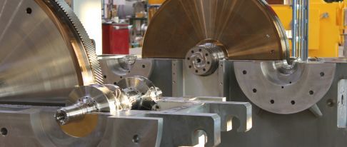

Single-helical with thrust collar[/caption]
This article contains excerpts from “High frequency vibrations on gears” by Dietmar Sterns of Renk AG and Michael Elbs of ISMB Dautermann at the 2017 Turbomachinery Symposium
When casing vibrations are measured on gear units, first decide between measuring velocity or measuring acceleration. Velocity should be measured in the frequency range of 10 Hz to 1000 Hz and displayed as an RMS value (refer to ISO 10816). Acceleration should be measured in the frequency range up to 10000 Hz and displayed as a 0-peak value.

To be able to use the acceleration signal for condition monitoring, it is necessary to: - Record the vibration baseline data during a loaded test (if such test is performed) and during commissioning. To record the baseline completely, vary the speed and power over the whole specified range or at least over the expected operating range.
Store the baseline data. This is the vibration signature of the gear unit in new, undamaged condition and is going to be used as a reference for any vibration data that will be recorded later, during operation.
Compare any acceleration values measured during operation with the baseline value recorded at the same operating conditions (speed, power, lube oil pressure, lube oil temperature).
If the total acceleration value recorded during operation shows a strong increase related to the baseline data recorded at the same operating conditions, then the vibration data should be investigated in detail. Ask the OEM and/or a specialist on machinery diagnosis for support.
In general, do not use the total value of the acceleration signal for machinery protection, i.e. for triggering a trip signal. However, the total value of the acceleration signal can be used for machinery diagnosis. It may be used to trigger an alarm, but the alarm value should depend on operating parameters such as speed and power. This variable alarm value should be set in accordance with the baseline values. The value of the acceleration signal in terms of condition monitoring can be increased by applying frequency filters on the acceleration signal, so that only the frequency band of interest is monitored. For example, a frequency band around the gear mesh frequency may be monitored.
