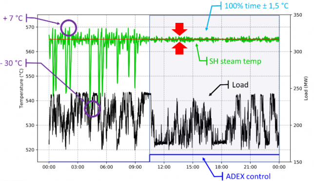

The Amorebieta plant continuously had peaks of +7°C and drops of up to -30°C in SH and RH steam temperature during AGC operation. Ever since ADEX Optimizers for SH and RH were implemented, the temperature is kept ±1.5°C around the setpoint during 100% of the time, even in AGC operation mode. As a result of the stabilization, the average steam temperature has increased 4.8°C, which implies a heat rate reduction of 0.12%.
ADEX Self-tuning AI enable thermal power plants to achieve the essential flexibility improvements to become more competitive in the increasingly demanding power generation markets.
ADEX Optimizer eliminates thermal fatigue and overshoot.[/caption]
Due to the improvement of the control performance, the plant has taken a step further. ADEX as implemented an optimization setpoint control that increases the steam temperature 2.1°C, reducing the rate an additional 0.05%. Keeping the temperature in a narrow band leads to a reduction of the induced thermal stress on superheater headers and steam turbines, which increases the equipment life expectancy and the plant availability.
