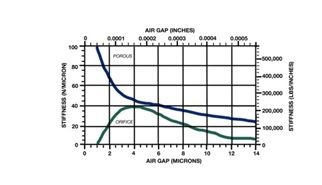

Figure 6: It is well known in the dry gas seal industry that small air gaps have very high stiffness. Since flow through a gap is a cubed function of the gap, small gaps are great for reducing flows. Porous compensation in gas bearing technology has shown the best results in low fly height application.
This also works well for very small gaps and so small flows. With porous bearings, a low initial lift is achieved with a low percentage of supply pressure, and the gap increases with increasing supply pressure. This is because the whole face contributes to lift, much like the exposed area of a hydraulic cylinder, as again illustrated in Figure 5. This makes porous bearings easier to use then orifice bearings.
So a fundamental problem for Don Bently was that the Orifice compensation he was using was not as good as dynamic bearings or porous externally pressurized bearings at small gaps that become critical in upset or extreme conditions.
