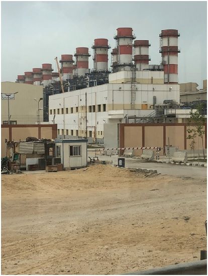

The Beni Suef plant in Egypt is the largest combined cycle facility in the world[/caption]
Egypt has had a problem with power availability for many years. So the government decided to handle it once and for all. The solution was three 4,800 MW combined cycle power plants (CCPPs) built simultaneously. These are the largest such facilities in the world. In total, Siemens supplied 24 gas turbines (GTs), 12 steam turbines (STs), 36 generators, 24 Benson heat recovery steam generators (HRSGs), and three 500 kV gas-insulated switchgear systems. Engineering, Procurement and Construction (EPC) world was provided by Siemens together with local partners(Orascom Construction and Elsewedy Electric).
The Beni Suef, New Capital and Burullus power plants were ordered, financed and built over a 27.5-month span. Together they represent approximately 40 percent of Egypt's power capacity, at the time of signing contracts, generating 14.4GW – enough to supply 40 million Egyptians with electricity.

The Beni Suef facility comprises 8 GTs, 4 STs, and 8 HRSGs. The GTs are Siemens SGT5-8000H advance class units. The STs are Siemens SST-5000 units manufactured at the Siemens factory in Muelheim, Germany. While they run on natural gas, oil fuel operation for one block consisting of 2 GTs and 1 ST is in the plan so that the plant can use it as a backup in the future.
The facility is more than 61% efficient. Each of the H-class turbines provides 400 MW. The inlet air operates at 820 Kg/s and gas consumption at 22 Kg/s per GT. The combustion temperature is 1550°C and the outlet temperature is 650°C. The Nile provides water for once through cooling. A Siemens SPPA-T3000 control system is used to run the plant. Emissions levels are maintained below 25 ppm NOx.

The two other plants are: the Burullus plant on the Mediterranean Sea mid-way between Alexandria and Damietta, which uses sea water for cooling; the New Capital plant in the desert near Cairo to power the new administrative capital for Egypt which is going to host around 5 million people once completed. The biggest air-cooled condensers in the world are used there instead of water cooling. Otherwise, the configurations for each CCPP are the same as Beni Suef: 8 Siemens SGT5-8000H GTs, and 4 SST5-5000 STs.
