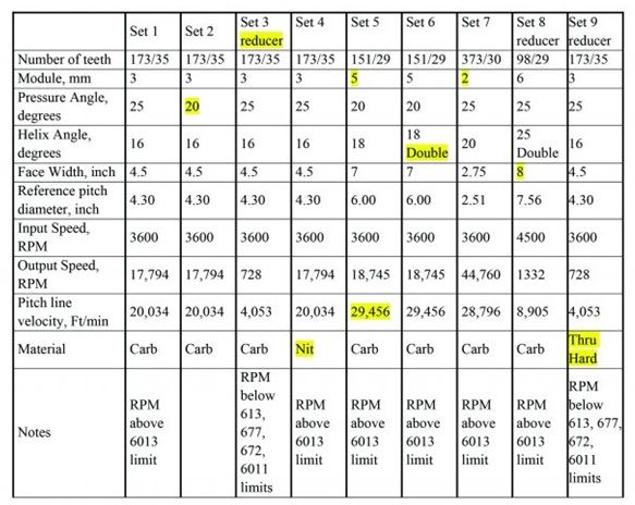

Specific gear sets
The gear sets used in this comparison are presented in Table 1, with changes between sets highlighted. All are alloy steel. Speeds range from 700 to 45,000 RPM. The resulting ratings range from 200 to over 18,000 HP. An even wider range of gears could have been analyzed, but that probably would not significantly change the general conclusions of this study. Note that the values and factors chosen are sufficient for the purposes of this study, but they were selected for simplicity; they do not represent actual gears in production and should not be used as a recommendation or guide for gear design.
Ratings are for 20 years of continuous operation, except ANSI/AGMA 6011-J14 specifies that ratings are for a minimum of 40,000 hours. Therefore, for comparison, ANSI/AGMA 6011 ratings are presented both for 40,000 hours and 175,200 hours (20 years). The ANSI/AGMA 6013 ratings are for 10,000 hours as stipulated. The rating results are presented even if the pinion speed or the pitch line velocity is too high or low for the standard to apply.

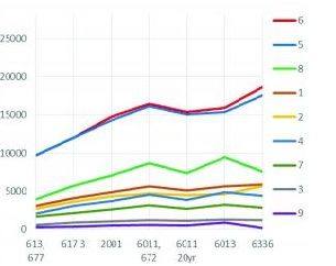

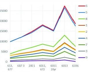

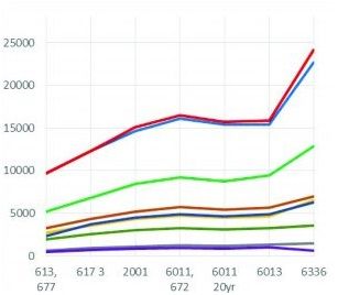

Figure 1 shows the pitting (surface durability) power rating and Figure 2 shows the bending strength ratings, with each line representing one gear set. Figure 3 shows the overall rating, which is simply the lower of the pitting and bending rating. For case- and surface-hardened gears, there is about a two-to-one ratio from the highest to lowest ratings for a specific gear set. This is a staggering difference. The API 613 ratings are consistently the lowest, both for bending and pitting. The highest ratings come from ISO 6336 and ANSI/AGMA 6013, though the inclusion of 6013 may be a bit unfair since it uses stress cycle factors for only 10,000 hours of operation. All other AGMA ratings are fairly consistent.
