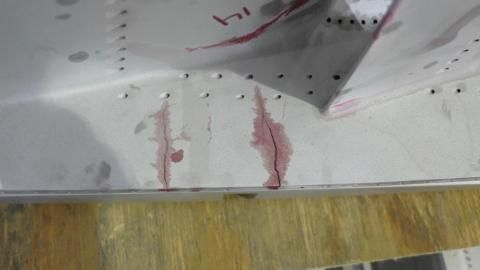

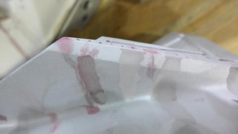

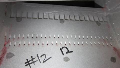

“Much of the testing I see that concludes brazes are better than welds avoids high strain range LCF testing.” Frost gave the attendees plenty of other tips like new casting quality might mean far more nozzle cracks in some part number series than in others (photo D);
(Photo D: Rev. M versus Rev. N Stage 1 Nozzle Segment Red Dye Cracking (1st Run – No Prior repairs))

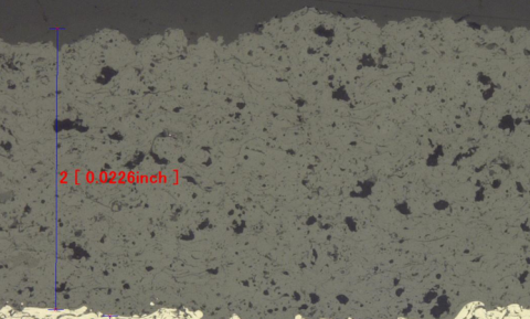

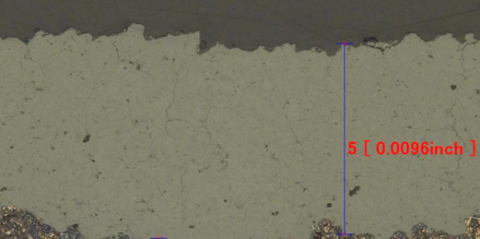

when you repair cracks, add TBC to make the nozzle more durable; for a longer lifespan, use high density low porosity coatings Frost added. Photo E (standard and high density TBC structures).
(Photo E – Standard TBC (left) and high density (right) TBC structures)
Frost pointed out that thicker TBC or uncontrolled application methods (manual vs. robotically sprayed) produce earlier spallation results. “A thinner TBC which is stays on is better than no TBC or patches of lost TBC which creates turbulence”.
