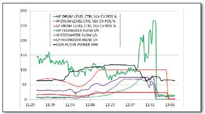

This was the third time the combustion turbine tripped as the plant tried ramping up from 60% load. Just like previous trips, the water level in the LP steam drum slowly receded until it reached lower water cut out (LWCO). Site personnel confirmed that the level control valve was receiving a signal to open and that the actuator was in fact opening the valve. They removed the valve for inspection and scoped the feedwater line for obstructions. No issues found.
Figure 1: Feedwater flow and level control valve position vs. time[/caption]

Note too, that the high-pressure-level control valve was progressively opening, yet there was little corresponding increase in HP feedwater.

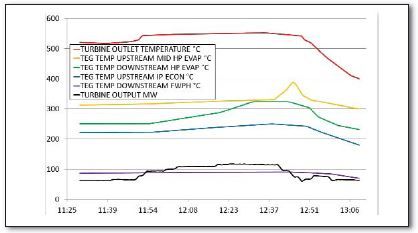

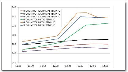

These points can be seen in Figure 1. Additionally, turbine exhaust gas temperature downstream of the HP boiler panels began to approach the temperature in the middle of the HP boiler panels (Figure 2), and the metal temperatures at the top of the HP drum began diverging from those at the bottom of the drum (Figure 3).

For these observations to occur simultaneously with the turbine ramp, there would need to be a significant amount of heat bypassing the HP boiler panels, causing the downstream sections to absorb more heat than originally intended. An inspection confirmed that the baffling around the HP boiler panels was in place and that the fouling on those heat transfer surfaces was not out of the ordinary.
Another potential cause for the turbine exhaust gas passing through the HP evaporator panels without significantly dropping temperature would be if the HP drum and upper sections of the evaporator panels were dry (Figure 3).
Heat transfer between a tube surface and boiling water is nominally 100 times more effective than for slowmoving, dry steam. With heat transfer at the top of the HP evaporator so ineffective, there was significantly more heat being passed to, and absorbed by, the IP and LP system. This resulted in an increase in their respective steam flows, while adversely effecting the HP steam production.
The increase in temperature at the top of the drum compared to the bottom was caused by superheating of the dry steam in the top of the HP evaporator panels flowing through the drum and out the saturated steam line.
Feedwater into the drum was helping to keep the bottom of the drum cool. Gross steaming in the HP economizer caused a choked flow and prevented more water from entering the drum even with the level control valve continuing to open.
