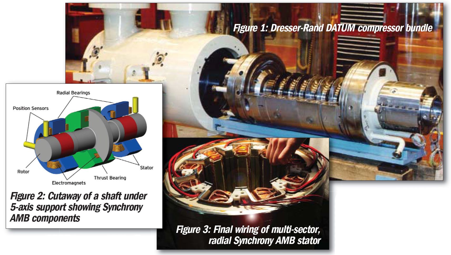

Figure 1: Dresser-Rand DATUM compressor bundle Figure 2: Cutaway of a shaft under 5-axis support showing Synchrony AMB components Figure 3: Final wiring of multi-sector, radial Synchrony AMB stator
Figure 3: Final wiring of multi-sector, radial Synchrony AMB stator[/caption]

In the early stages of their development, AMBs had to be much larger than conventional bearings due to limitations in available bearing pressure and sensor technology. Recent advances in miniaturization and standardization have shifted the equation in favor of AMBs. The design of magnetic bearing actuators has improved. Increasing the amount of electrical steel at the bore of the stator has boosted bearing pressure, closing the gap. And the use of eddy current sensors has allowed the axial length of AMBs to be decreased (Figure 1).
Advances in frequency-modulated sensing techniques and digital electronics have also reduced the size of the associated control systems. Though at one time as big as a refrigerator, AMB controllers are now similar in size to a household DVD player. Wiring between electromagnets, coils and sensors has also been lessened (Figure 2).
AMBs operate on the principal of magnetic levitation. Two radial magnetic bearings are used to support and position a shaft in the lateral (radial) directions and one thrust bearing is used to support and position the shaft along the longitudinal (axial) direction. A shaft that is completely supported by magnetic bearings provides support along five axes: two axes for each radial bearing (x-y) and one translational axis (z) for the thrust bearing.
