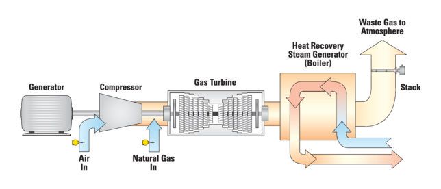

Flow meters often measure both the fluid flow rate and total flow. Given the operating environment of electric power plants and oil & gas refineries, flow meters generally require hazardous area approvals and often must be IEC 61508/61511 (SIL) compliant as part of a Safety Instrumented System (SIS). The most common turbomachinery flow measurement applications involve turbines and compressors.
Accurate and consistent air and gas flow measurement over a wide turndown range is particularly important in the electric power industry for steam driven turbine systems, including combined cycle gas turbines (CCGT), combined heat and power (CHP), and co-generation systems using waste gases.
Repeatable measurement of the air-to-gas fuel mixture supports efficient boiler operations to generate steam as needed. Monitoring of the mass flow rate of hydrogen in cooling systems allows early detection of leaks to minimize environmental impact. The ability to operate over a wide turndown range is important to support variable power demand.
Similarly, the operation of these compressor stations requires accurate natural gas flow measurement from the pipeline. Monitoring the health of dry gas seals, which serve as a back-up leakage system to prevent the gas from accidentally leaking into the atmosphere, can also reduce operational costs.

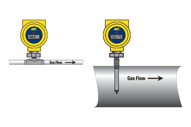

Spool type flow meters are installed as a section of the process piping. Insertion flow meters are mounted through a tap point to the pipe section. Some flow meters can only be installed using one method. Coriolis meters must be installed inline (part of the piping). Thermal meters, some DP meters (orifice plates and averaging pitot tubes), and others can be installed in either inline or insertion configurations. ■
Inline versus insertion flow meter installations
