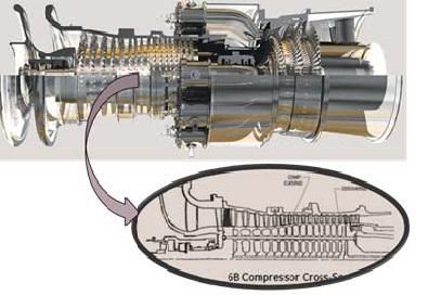

QG2 : 2 trains (7.8 MTPA) and QG3/4 : 2 trains (7.8 MTPA). QG1 facilities operate six Fr6B gas turbines to drive power generators for meeting the electric power demand. HGPI and MI of Fr6B turbines operate every 32K & 64K hours respectively.

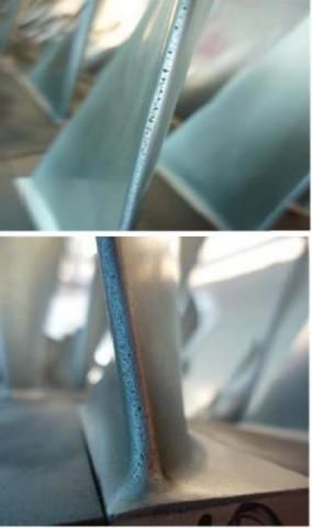

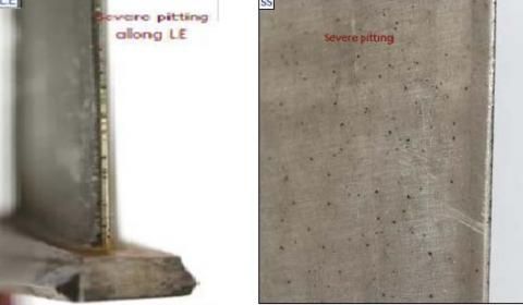

Pitting corrosion was observed on the first four rows of Rotating and Stationary blades.
In Leading Edge, it was from root to tip in multiple and cluster formations, volumetric dimensions of the pits estimated between 0.25x0.25mm and 0.5x0.5mm (FBH reference), external dimensions of the pits up to 1.5mm, and liquid erosion was detected. In the Airfoil, corrosion pitting was affecting areas 2 and 5 in multiple and cluster types with the estimated volume between 0.25x0.25mm and 0.5x0.5mm. The Fillet had randomly distributed smaller pits with estimated volume of 0.25x0.25mm.

All the examined blades showed eroded coating along LE and severe pitting corrosion damage along LE and across the whole airfoil. The severity of damage was more than acceptable tolerances and limits set by the vendor for reliable turbine operation. Continued operation of the gas turbine with defective or damaged blades may result in airfoil liberation and resultant downstream compressor damage.
