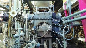

A mechanical actuator was changed to a REXA electraulic actuator in order to improve steam turbine reliability and performance[/caption]

Compressor Controls Corporation (CCC) recently implemented a mechanical retrofit for a U.S. refinery experiencing large swings (100-200 rpm) in the speed control of a steam turbine (ST). Speed instability was caused by a subpar governor valve actuation system. The sticking actuator could not maintain the setpoint target and had recently caused a process trip of the main air blower.
Sticky actuators
Difficulties with speed control meant the ST had to be operated manually and at a higher target speed than desired. In addition, load sharing with a secondary air blower could not be implemented, and the operator had to use the blow-off valve to adjust the air flow. Additionally, the ST could not use the existing CCC automatic start-up sequence because of the sticking actuator.
The actuation system specified was a REXA Electraulic self-contained unit. It uses a position-controlled power module driven by a 4-20 ma signal to turn an internal oil gear pump that displaces hydraulic fluid from one side of cylinder piston to the other.
A rod extending from the cylinder is mechanically connected to the steam valve rack and able to position the rack from the closed to open position. The system has no need for an external oil supply source.
The actuation retrofit was executed during an unscheduled outage. As a result, the turbomachinery train could more accurately match its performance with the desired process set point. This also allowed use of the automatic startup sequencing and load sharing features of the CCC control system.
