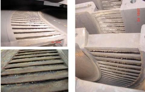

Fouling of turbine rotor blades and static guide vanes was observed. The fouling zone was just ahead of the saturation zone in the steam turbine. Fouling consists of water soluble chemicals [NaCl, NaOH] bound with Insoluble Oxides [Fe, Si, Al] greater than 50 ppb

(Fouling in steam turbines)
For Turbine #1, a 3-Stage turbine, no extraction machine with no turning gear, the selected cleaning method was offline mechanical cleaning with disassembly was chosen
For Turbine #2, a 10-Stage turbine with extraction and turning gear, offline slow roll soak with hot water (no disassembly) was selected.
