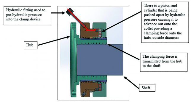

The clamped shaft-end connection is an emerging approach that is gaining in popularity. This technology has been discussed by the API 671 Task Force; a section addressing clamped shaft-end connections will be in the 5th edition. It works by applying a clamping force to the outside diameter of the hub, squeezing the hub onto the shaft.
Figure 1: A simple hydraulic version of a clamped shaft-end connection
A couple of different designs are already available on the market (Figure 1). A hydraulic version uses mechanical devices to maintain clamping force. It is hydraulically activated and mechanically locked in place. There are all-mechanical versions, as well. Retrofitting can be done on tapered and keyed shafts.
An advantage is that it eliminates keys, splines and tapered shaft-ends. Keys and splines produce stress concentration in machine shafts. Tapered shaft-ends and hub bores can be expensive to produce and require special tooling.
Clamped shaft-end connections allow designs using straight, cylindrical, slip fit surfaces. Additionally, a high squeeze capacity translates into smaller shafting and bearing requirements. Further benefits include elimination of potential shaft damage, a reduction of overhung moment and keyless connectivity. On traditional shaft-end connections, high interference fits require the hub to be cut off or dragged off with a puller tool. This can cause damage. However, a large clamping force can be applied to the shaft without causing any harm.
