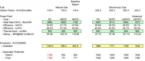

The following table has been modified from the original 2014 version to calculate the Advanced-USCPC CO
 emissions based on a 50% LHV value with the 203.3 lb-CO
/mmBtu carbon factor. The NGCC values are shown, as before.
The Natural Gas Combined Cycle (NGCC) power plant meets the 832 lb-CO
/MWh interim level now, and the final 771 level without any form of CO
 abatement, if expected efficiency gains are realized.

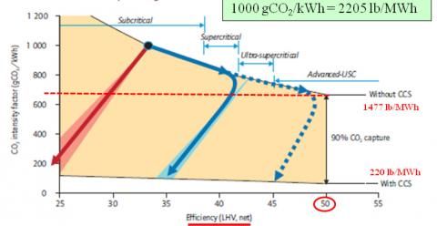

The graphic shown below was developed as part of an International Energy Agency “Road Mapping” exercise toward a High-Efficiency, Low-Emissions (HELE) coal fired power plant, shown as an Advanced Ultra-Supercritical Pulverized Coal (Advanced-USCPC).
The graphic indicates that at 50% LHV efficiency, the CO
 emissions would be ~1477 lb-CO
/MWh (~670 gCO
/kWh).
The Advanced Ultra Supercritical Pulverized Coal Plant(USCPC) at 1540 lb-CO2/MWh, would appear to meet the interim full load threshold level of 1534 lb-CO
/MWh, but another 15% efficiency improvement would be required to meet the final threshold of 1305 lb-CO
/MWh. Either that, or 15% Carbon Capture would be required.

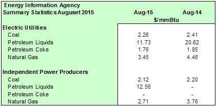

The fuel cost differences are also narrowing, as shown in the following data extracted from the Energy Information Agency’s August 2015 year-over-year comparison, reducing coal’s historical price per mmBtu advantage.
At a nominal 550MW, the annual fuel cost difference is $23 million per year, in favor of the Advanced-USC, requiring a 40-year simple payback on the ̴$1.0 billion first cost difference.
If the differences in CO
 emissions were added at $60/Mt, the combined fuel and CO
 operating costs would shift in favor of the NGCC at $30 million per year.
The breakeven point would be about $25/Mt of CO
 at the fuel and efficiency rates.
