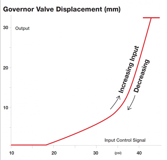

Off-load hysteresis test
Hysteresis is the phenomenon in which the value of a physical property lags behind changes in the effect causing it; for instance, when magnetic induction lags behind the magnetizing force. A hysteresis test is applicable to any control system with mechanical parts. Starting from a convenient setting, the input control signal is increased in steps in the upwards direction, without reversing the direction of the input. When full range is reached, the input signal is reduced in steps until the minimum setting is reached. The signal is then increased until the original setting is obtained. At each step, the matching output is measured.
A plot of input versus output reveals the presence of hysteresis and allows its extent to be measured, usually as a percentage range. In governing systems, the input signal is usually a control oil pressure which is given from the speed governor.
The steam control valve position is the output and can be obtained with suitably mounted mechanical dial gauges. The valve stem itself may not be accessible and movement of an operating servo may have to be measured instead. Displacement transducers and electronic pressure transducers of suitable ranges can also be used. These enable data to be collected using a datalogger and computer. Another way using an XY plotter is shown in Figure 1. Valve movement is shown on the vertical scale. The horizontal scale is the control oil pressure. Hysteresis here was negligible.
Figure 1: Hysteresis test on a governor valve[/caption]
This test was performed after maintenance. The up- and down-range plots coincide, as would be expected. Test measurements can be made manually. But on large machines, it requires careful coordination of readings if those taking them are not in sight of each other.

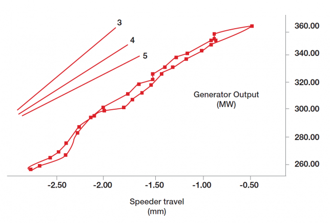

During manufacture, the characteristics of the speed governor are tested and the fly-weight springs adjusted to give the design output of axial movement with speed change. This machine should have had a speed regulation of 4%, which corresponds to 5% load per 0.1Hz of speed variation. Speed change of 4% for a 3000r/min machine is 120 r/min, which corresponds to a load from zero to full output. Over this relatively small speed range, the output of the governor is closely proportional to speed.
For this design, a 4% speed change corresponds to a governor sleeve travel of 7.4mm. Using this approach for other selected values of speed regulation, lines of constant speed regulation can be constructed and drawn on axes of speeder travel versus output, as shown on Figure 2.
On test from 250 MW to 360 MW, the speeder travel was measured using a Linear Variable Displacement Transformer (LVDT). Other transducers were connected to measure displacements of other linkages and servo relays in the system, control oil pressures, inlet steam pressure and other variables. A connection was also made to the main output metering. A data logger was used to record the data at ten-second intervals. Earlier in the life of the machine, these tests were done initially and satisfactorily using manual measurements, but errors can be made when reading small distances with a micrometer under the stress of test conditions (hot and noisy).
The measured load values were corrected to the load expected at standard terminal conditions of steam pressure and temperature. With a printout of data at each 10 seconds, sets of readings can be selected at rated values of temperature and pressure, thus avoiding the need for any corrections.
Figure 2: Load vs Speeder /Load Changer travel on test of a large steam turbine generator. Results are shown with gradients of regulation for 3%, 4% and 5%.[/caption]
The variation in incremental regulation with load can be seen by comparing gradient sections of the test curve with the calculated lines of constant regulation (3, 4 and 5 in Figure 2). Incremental regulation can be seen to be close to the design value of 4%, with departure at higher loads. If desired, it can also be read off at uniform intervals of load and drawn versus load. Hysteresis can be observed, measured and expressed as a percentage range: 0.06Hz maximum is desirable.
