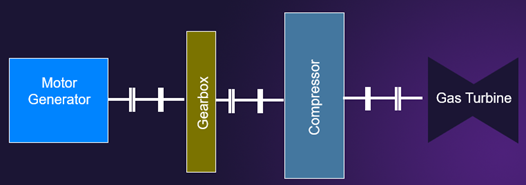

Depending on the application and specific type of equipment used, multiple dual drive configurations are possible. In the case of centrifugal or integrally geared compressors with two shaft ends available, a typical arrangement would involve installing an electric motor or motor-generator on one side of the compressor shaft end and the gas turbine on the other. The need for clutches and gearboxes will be determined by the type of motor used and operation of the compression train.
For centrifugal compressors, a typical train configuration would comprise a gas turbine with a clutch on one side and an electric motor with a speed increasing gearbox and a clutch on the other side. With such a setup, the electric motor could be used as the primary driver (the gas turbine as backup) when electricity is available from the grid. Switching between the motor and the gas turbine is possible via engagement and disengagement of the clutches, with minimal disruption to pipeline operation.

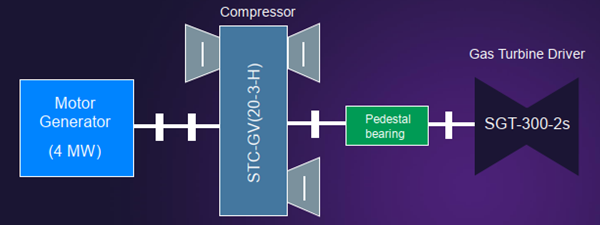

A utility-scale LNG liquefaction plant in the Northeast United States is being built. It features a gas/electric drive system. It combines a Siemens Energy SGT-300 gas turbine (8 MW), STC-GV integrally geared compressor, and electric motor-generator to ensure stable and efficient operation of the refrigeration/liquefaction train. The compressor is pinion-driven from the gas turbine side and bull gear-driven from the motor-generator side with no need for clutches or a separate gearbox. A single lube oil system supplies oil for the entire train.
During cold months, the gas turbine drives the N₂ refrigeration compressor and the generator, supplying about 3 MW of additional self-generated power to meet the plant’s electrical demand. This reduces the need to purchase power from the grid. When turbine output decreases during summer, the motor-generator acts as a motor to supply additional power to the compression system. After start-up, the facility is expected to produce a baseload of 170,000 gallons of LNG per day and up to as much as 250,000 gallons without shutting down.

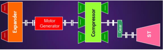

The hybrid drive concept has also garnered attention in the downstream sector. In refineries, the Purified Terephthalic Acid (PTA) process is exothermic (releases heat). It normally includes a steam turbine, one or two hot gas expanders, and a motor/generator to export power. The motor/generator starts the process by driving the train to produce air. Once the process is producing steam and off gas, the motor generator is used to export power to the grid. The train is not stopped.
