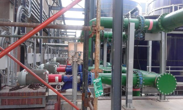

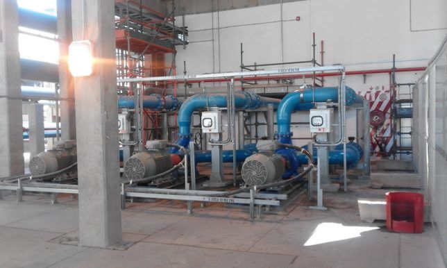

Many modern centrifugal pumps in wastewater services have variable speed drives (VSD) that operate over a wide range of flows, head, speeds and conditions. Large pumps are often needed yet space is usually limited. Therefore, vertical pumps are commonly specified. They offer a compact configuration and better economics compared to horizontal pumps in many, though not all, wastewater services.
Priming has been a major issue. As a result, pumps should operate with a positive suction head. Preferably, each pump should have an individual suction line. The suction source and piping layout should avoid turbulence to prevent vortex formation.
The fill time and minimum pump cycle time should be considered in the sizing of storage units, tanks and wet wells. Effective volume (between pump start and stop) should ideally be designed to provide no more than one or two starts per hour.
VSDs are usually needed as pump systems and controls tend to operate at varying delivery rates. Capacity should be based on peak hourly flow and should be adequate to maintain the wastewater velocity within minimum and maximum limits to avoid operational problems, high head loss and so on. A minimum velocity of 0.7 m/s and maximum velocity of 2.5 m/s are recommended.
For industrial wastewater treatment plants and facilities, it is common to have pumps working in parallel. If the maximum rated capacity of the pumping system is supplied by two or more normally operating units, the capacity of standby units should be at least 50% of the system’s maximum rated capacity.
Attention is needed when pumps operate in parallel. One pump should be started at minimum VSD speed. Pump speed is increased as demand rises until the pump is at maximum speed. A further rise in demand initiates the start of a second pump and in turn a third pump once two pumps are running at full speed. The pump stop should follow a similar sequence based on falling of demand.
Material selection
For wastewater and abrasive or corrosive liquids, material selection is vital. Fluid properties, corrosion, erosion, economy, construction and other factors should be used in pump selection. It is best for any hardware in contact with industrial wastewater to be fabricated from proper corrosion-resistant materials. Type 316 stainless steel material is often suitable. Stainless steel vertical multistage pumps and booster pump sets are commonly used in industrial wastewater handling and pumping systems.
Take the case of a pumping station moving wastewater from a plant discharge to a wastewater treatment unit located offsite. The plant’s operating capacity and head were 2,000 m3/h and 27 m respectively, during the first year. After that, other production came online, the flow increased to 7,500 m3/h and head to 60 m. Because of the difference in head, the only way to use the same pump model for both development stages was to use VSDs.
The first group of pumps operated as 1+1 arrangement (1 operating + 1 standby) during the first year. It ran at low speed. Five pumps were needed in the second year (two existing VSD pumps and three new pumps). These operated in 3+2 arrangement (3 operating + 2 standby). Each pump provides a capacity and head of 2,500 m3/h and 60 m, respectively.
In this way, two VSD-driven pumps can be installed for the first year of operation. Each pump has its own suction line. Proper valves and flanges are provided at the discharge header so three additional pumps of the same kind could be installed later without any interruption in operation.
