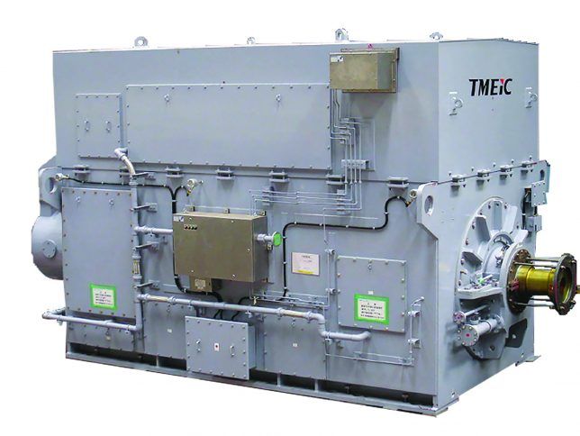

Caption: High-speed synchronous motor used for driving a centrifugal compressor in a pipeline compressor station, one of forty-three such motor and drive pairs currently operating on a large Asian gas pipeline. The motors are Totally Enclosed Water to Air Cooled (TEWAC) type, using internal air circulation to cool the motor and an integral water-air heat exchanger to remove heat from the casing. The sleeve bearings are forced oil lubricated and cooled, and protected from shaft currents

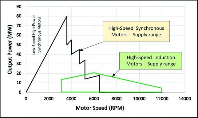

The exciter’s stator is fixed on its frame and both are assembled on the motor frame or motor base while its rotor rotates with the motor shaft. The exciter DC current can be varied by an external control to the AC input. With use of the VFD, synchronization is achieved at any speed. Both synchronous and induction motors are available for high-speed operation (Figure 1).
Figure 1: Supply range of high-speed motors
In general, synchronous motors can provide higher power and energy efficiency, but are more expensive. Induction motors provide speeds up to 12,000 rpm, but have a lower energy efficiency. VFD Motor starting and variable speed are provided by a VFD.
