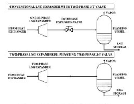

Conventional Single-Phase Versus
Two-Phase LNG Expander[/caption]

In modern refrigeration process plants the liquefaction of natural gas is achieved at increasingly higher pressure and mass flow to improve the overall process efficiency. Trends for future LNG plants are naturally towards larger mass flow and higher pressure to secure the efficiency gains offered. The condensed and highly pressurized LNG is expanded across a liquid-vapour two-phase expander to a lower pressure suitable for storage and transportation of the liquefied gas. This expansion process generates a certain amount of vapour and the remaining liquid is further cooled.
The objective of the two-phase LNG expander is to increase the amount of liquid and to decrease the amount of vapour at the expander outlet. For the conventional process the outlet pressure of the LNG expander is approximately 500 kPa (72.5psia) above the saturation pressure and the remaining pressure energy is throttled across a flashing two-phase J-T valve. For the new process employing two-phase LNG expanders the outlet pressure of the expander is equal to the outlet pressure of the J-T valve in the conventional process. The two-phase LNG expander converts the total available pressure into electrical energy and reduces the enthalpy of the LNG, decreasing the amount of vapour and increasing the amount of liquid.
