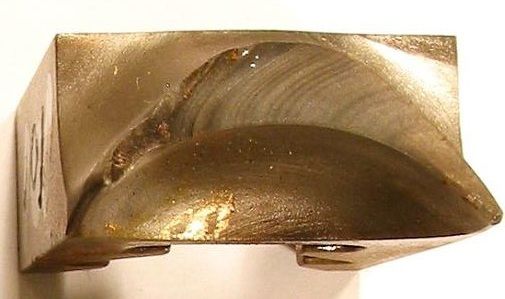

High cycle fatigue failure of steam turbine airfoil[/caption]
Fatigue
Fatigue is the progressive localized permanent structural change that occurs in a material subjected to repeated or fluctuating strains at stresses having a maximum value less than the tensile strength of the material.  Therefore failures that occur under cyclic loading are termed fatigue failures.  These can be vibration stresses on blades, alternating bending loads on shafts, fluctuating thermal stresses during start-stop cycles, etc.  There are two types of fatigue: low cycle fatigue (LCF) and high cycle fatigue (HCF). Traditionally, low cycle fatigue failure is classified occurring below 104 cycles, and high cycle fatigue is above that number.  An important distinction between HCF and LCF is that in HCF most of the fatigue life is spent in crack initiation, whereas in LCF most of the life is spent in crack propagation because cracks are found to initiate within three to 10 percent of the fatigue life. HCF is usually associated with lower stress, while LCF usually occurs under higher stress.  Most failures of rotating turbomachinery are due to high cycle fatigue.  These failures generally occur at loads that when applied statically would produce little affect.  Fatigue occurs in three stages: I) Crack initiation II) Crack propagation III) Final fracture overload
Fatigue is a particularly insidious failure mechanism.  A fatigue failure spends 80-90% of its life in crack initiation.  This means a fatigue crack is not detectable by NDE inspection until the crack propagation stage which is the last 10-20% of its life.  A component can be reaching the end of its life and yet show no physical evidence in which to identify impending failure.  Typical fatigue fractures are relatively flat and smooth and in some cases show beachmarks that indicate successive positions of the advancing crack tip.  Fatigue is most commonly transgranular with striations, which each one indicates a single cycle of stress.
