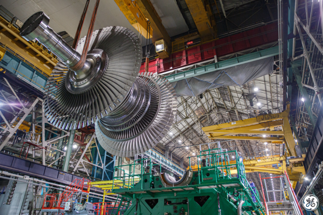

GE Steam Power designed and manufactured the largest-ever last-stage blade for its Arabelle’s low pressure rotor. The 75-inch last-stage blade will be used for the 3.2GW Hinkley Point C nuclear power plant.
Once completed, the Arabelle steam turbine will be the most powerful nuclear steam turbine in operation. Hinkley Point C nuclear power station is a project to construct a 3,200 MWe nuclear power station with two EPR reactors in Somerset, England.
The fully assembled low pressure rotor was tested at GE’s factory in Belfort, France and inserted into a balancing pit specifically designed for large turbines. The 8-meter-wide bladed module rotated at a speed of 1,500 revolutions per minute, similar to the future site conditions. The rotor is set to be shipped from Belfort factory to Hinkley Point C site in 2021.
