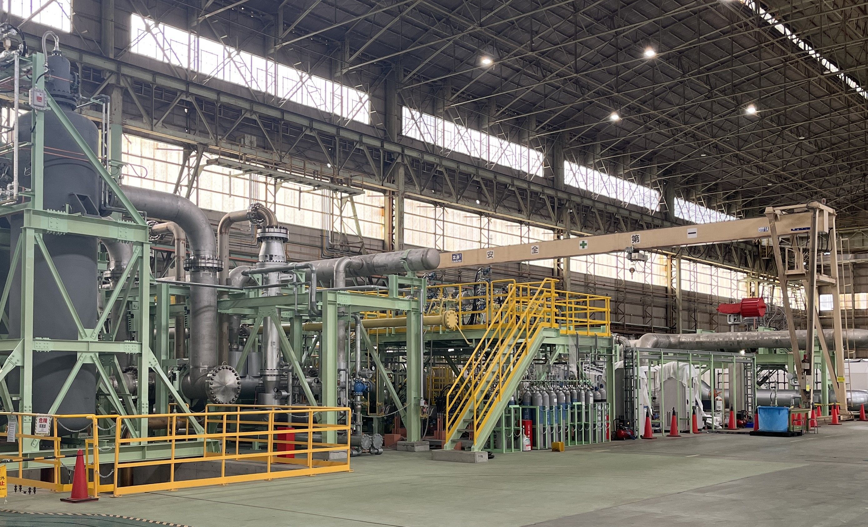

IHI Corp. (IHI) and GE Vernova completed a new large-scale combustion test facility in Hyogo, Japan, at IHI’s Aioi Works facility. It’s designed to test advanced combustion systems at GE Vernova’s F-class gas turbine operating conditions, including pressure, temperature, air, and fuel flow rates. The end goal is to develop a commercially viable 100% ammonia-powered gas turbine by 2030.

This summer, IHI will be conducting rigorous combustion tests using full-scale prototype combustors operating on 100% ammonia. IHI will bring its ammonia combustion expertise, and GE Vernova will bring its global technical teams and shared best practices developed at GE Vernova’s advanced combustion test facility in Greenville, South Carolina.
