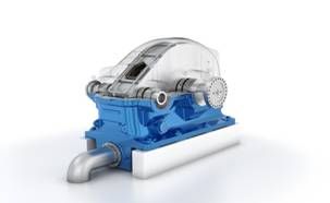

Also at PowerGen, Voith debuted its BHS AeroMaXX technology for turbo parallel-shaft gear units. The inner housing and optimized sleeve bearings are said to reduce power loss and oil consumption by 30% or more. This solution has a passive-mechanical character and does not require any additional accessories. Due to the high pitch-line velocities of up to 200 m/s, oil swirling and oil squeezing in the gear mesh account for a substantial part of the power loss of high-speed turbo gear units. The AeroMaXX technology reduces these losses by separating the lubrication from the cooling.
An inner housing in the direct vicinity of the gear set absorbs heat and dissipates it into the external surface on the inner housing via cooling oil. This means that a substantially smaller volume of oil is required for the actual lubrication of the teeth-contact surfaces and the swirling oil and air mixture is minimized.
AeroMaXX is said to increase gear unit efficiency by up to 0.5%. At the same time, oil consumption is reduced by at least 30%. AeroMaXX is designed for high pitch-line velocities in connection with medium-to-high power that occurs in the driveline of power plants with compressors and generators.
 (Voith BHS AeroMaxx)
