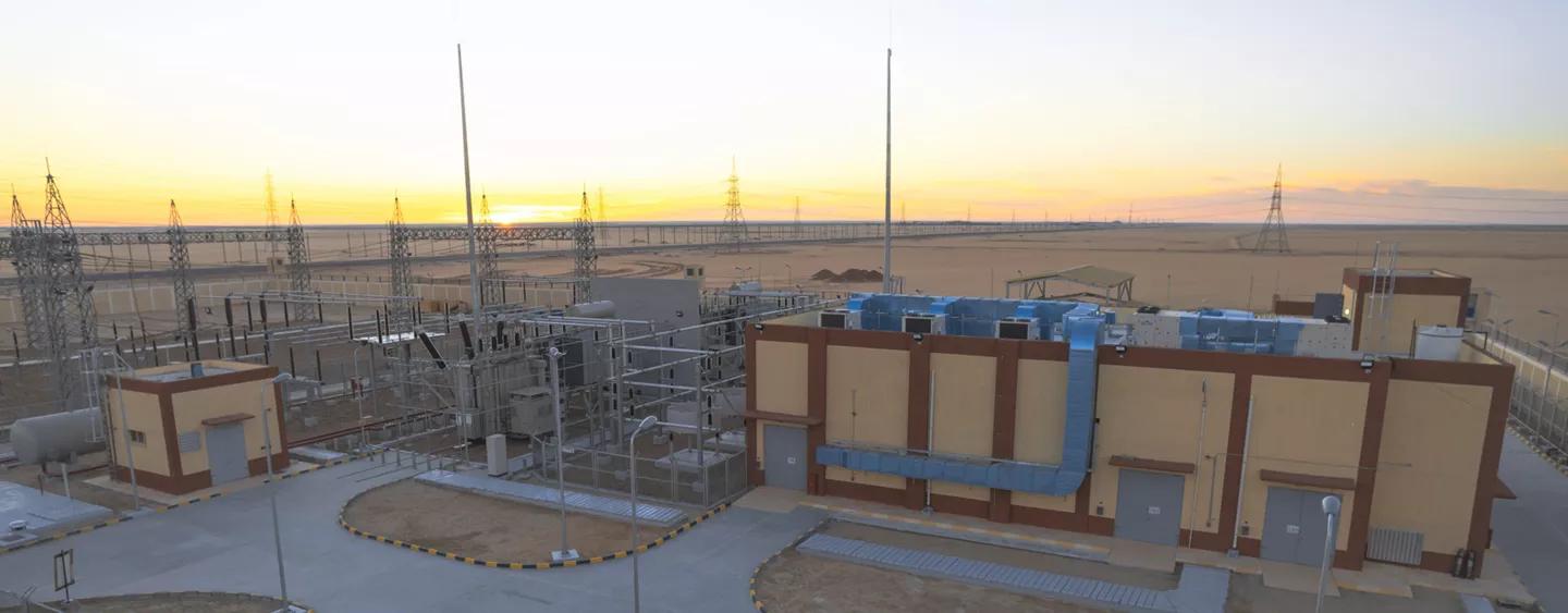

Hitachi Energy is to design and install a power quality solution for SP Energy Networks to enhance the flow of renewable energy from Scotland to England and stabilize the grid. SP Energy Networks’ substation in Eccles, United Kingdom is equipped with two sets of an SVC Light STATCOM and a synchronous condenser controlled by the MACH control system connected at a common central node.
“The innovative power quality solution will increase the transfer capacity between Scotland and England by up to 280 MW by improving the transmission network’s strength and stability as more renewable generation is connected in Scotland,” said Billy Moore, Senior Project Manager at SP Energy Networks. “The criticality of technology such as this will become more important as we reduce the usage of fossil fuels.”
The STATCOM installations use Hitachi Energy’s power electronics and the MACH control and protection solution to provide system strength, instant voltage control, and maximum power flow. The SVC Light STATCOM and synchronous condenser with combined control generate or absorb reactive power to manage the grid voltage and maintain system stability and resilience. A MACH Control System uses computers, micro-controllers, and digital signal processors to act as the control center for the SVC Light.
