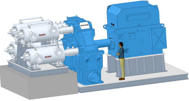

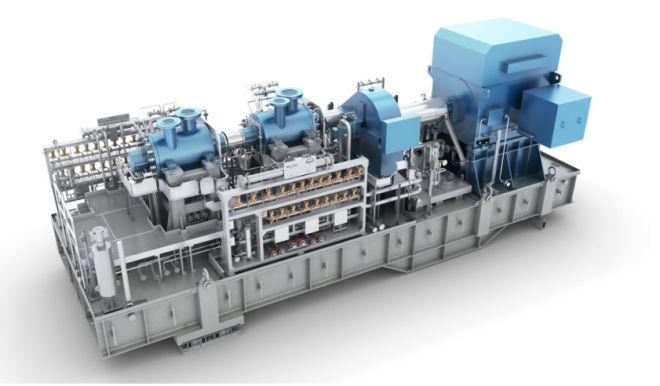

Hydrogen compressors are typically found in refinery applications. Hence Hydrogen compressor designs have been developed to suit the refinery application range and scale. However, significant modification is required in the design of such compressors to make them suitable for the pipeline compressors application considering higher volumetric flowrate of the pipeline compressors than the refinery one. Specifically for the centrifugal compressors, machine manufacturers have developed the concepts of compact compressor train casings arrangement (Figure-1) which is quite different than the typical compressor train casings arrangement in series (Figure-2). Thus, it is imperative that an engineer stays up to date on any and all design developments.

Few interface related challenges for the newly developed machines can be understood from the example of the centrifugal compressor developed for Hydrogen service as shown in Figure-1. Piping layout around the machine will be significantly different and more complex than the piping layout of the conventional machines with separate casings in series shown in Figure-2. Design of machine auxiliaries like lube oil consoles, seal gas treatment unit, fuel gas treatment unit (in case of gas turbine), and inter stage coolers will differ from conventional units. Location of these auxiliaries with respect to the machine skid needs careful evaluation to ensure proper functioning of the unit (for example, Location of Lube oil Rundown tank with respect to the centerline of the compressor). Shelter design and material handling facilities also need to be designed considering the compressor and auxiliary layout plan. This is expected to be complex for the compressors shown in Figure-1.
