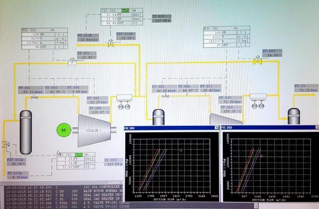

The following picture shows a typical process screen
With reference to above process screen, the following table compares the pressures and temperatures from PT/TT transducers to the value predicted by software:
In the previous tables it can be noted how the maximum error calculated is less than 1 %.The same comparison has been executed for Head and Polytropic efficiency.
Measured errors have been considered tolerable for the purpose of the evaluation of compressor field performance.The analysis developed obtained an evaluation of the efficiency deviation (difference between the actual compressor efficiency and the expected efficiency in the actual operative conditions). Time trends of calculation results provided a useful analytical basis for compressor maintenance decisions.
