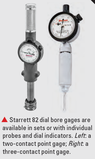

Dial bore gages are available in two- or three-point contact with a choice of dial reading, imperial, metric, or fractional graduations. Measurements are taken by comparison, so some type of setting master should be used as a reference standard. Set the gage as close to the hole being measured as possible to maximize the hole measurement.

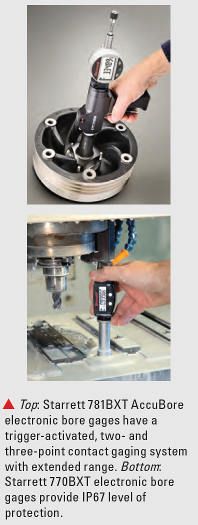

As previously mentioned, electronic gages enable measurement data collection and documentation for SPC purposes, which is an advantage over dial or vernier gages. In addition, some electronic gages are IP67-rated for protection against harsh ambient shop environments with coolant, dust/dirt, etc. There are also unique pistol grip gages with trigger activation that allow for fast access to the hole being measured. Both vernier and electronic gages are available in two- or three-point contact styles.

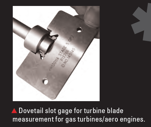

Sometimes custom gaging solutions are available to solve specific turbomachinery application challenges. For example, a dovetail slot gage can accurately measure internal and external holes in gas turbines and aerospace engines. Fan blade gage versions provide internal measurements of the dovetail seat face width and bottom lobe width. A turbine blade version offers internal single-side measurement for setup, and symmetry and internal double-side measurement for overall width. An external dovetail gage offers measurement of the dovetail slot with ball contacts as well as on machine measurement.
