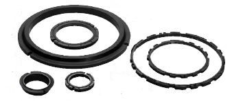

To seal the oil lubricant within the gearbox and protect it from leaking at the point where the shaft enters the gearbox, most aircraft gearboxes use face seals. These usually contain a carbon-graphite stationary ring and a silicon carbide or tungsten carbide rotating ring. These rings that make the dynamic face seal are lapped flat and held together with springs or magnets so liquids cannot flow between the ring faces even though they are spinning against each other at high rpm.
The two rings in relative motion are sealed to the shaft or the gear box housing with static seal rings such as polymeric O-rings. Designers use spiral grooves, straight grooves, and wedges to channel or pump a thin film of air or oil between the two sliding sealing faces. This creates aerodynamic or hydrodynamic lift, which reduces the friction and wear of the seal faces (Figure 1).
Figure 1: Metcar Grade M-45 is used in air motor starter seals because of its self-lubricating qualities at the required operating conditions[/caption]
