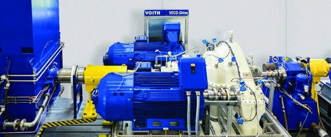

The Voith VECO-Drive steps up input speed and generates a high output speed for compressors or pumps. Since additional power is supplied to the drive train, a smaller main motor can be used for this variable speed drive
Variable speed drive
The Voith VECO-Drive is the first member of a new product family in the field of speed control for compressors and pumps. It is an electric superimposing gear and is inspired by the established principle of the Voith Vorecon with more than 600 installations. The VECO-Drive combines a mechanical planetary gear with frequency-controlled servo motors. The electrical superimposing gear is an efficient way to make speed variable. Servo motors are used to drive a planetary gear. Since they only need a small part of rated power, an overall component efficiency of more than 97% is reached. This saves energy and reduces operating expenditures. Servo motors are installed between a constant speed motor and a variable speed compressor or pump. This combines the reliability of mechanical gears with the productivity of low-voltage variable frequency drives (VFDs). Since additional power is supplied to the drive train, a smaller main motor can be used. This saves capital expenditures. The servo motor can be used as a starter to protect the electric grid from high inrush currents.
A prototype system was built and tested in Crailsheim, Germany. It was designed for compressor and pump ap-plications with a maximum output speed of 15,000 rpm, maximum output power of 15 MW and a speed adjustment range from 50% to 100%. The VECO-Drive has about 2% higher efficiency compared to a typical full-scale medium voltage VFD train with a step-up gearbox over the whole speed range. This equates to an annual energy reduction of more than 2,000 MWh. It is a modular system with individual specifications for different application types, classes of explosion protection and speed levels. Functions like the integrated PLC-based output controller, user interfaces, condition monitoring and simplified maintenance are part of the scope of supply, whereas remote access and remote diagnosis are available on demand. voith.com
