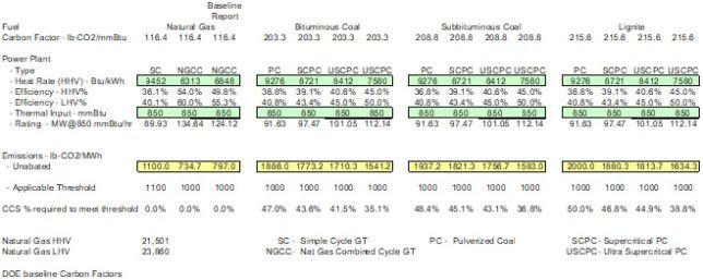

I authored the following table in 2014 for the original NSPS using the DOE Baseline data. It is not hard to see how the proposed 2019 NSPS set its thresholds. In a word “Unabated” or in modern day jargon, “Whatever!”
Given how things work these days, the EPA will proceed. The question is whether this will induce any public utility to actually commit to build a new coal plant?The NGCC plants are 1/3 the first cost, 30% more efficient and with less of an abatement overhang.
I think not! I don’t see any public utility making such a decision.
