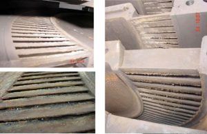

Fouling of diaphragm guide vanes[/caption]
At a facility, the steam turbines driving critical compressors were losing power and speed. The governor/steam valve was unable to maintain desired rpm. Unit production reduced and revenue loss was occuring. The cause of the problem was fouling of turbine rotor blades and static guide vanes. The fouling was water soluble chemicals [NaCl, NaOH] bound with insoluble oxides [Fe, Si, Al] > 50 ppb

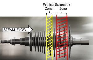

Fouling occurs in stages prior to saturation[/caption]
Solid deposits of both soluble and insoluble material can be safely and effectively removed from turbine blades and guide vanes. There are removal methods available that do not require disassembly of the turbine. The key mechanism for removing the solids without disassembly of the machinery is to dissolve the soluble material thus releasing the insoluble material. This may be done by:
  • Flushing with hot water while slow rolling the turbine or
  • Moving the saturation zone back through the fouling zone at normal RPM while monitoring conductivity (hardness).
