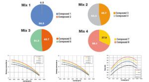

That makes it possible to determine the consequence of each variation in gas components with regard to overall compressor performance. The study also looked at machine performance for gas mixes with the same molecular weight but with a different gas composition.
Four different variations of gas mixtures were considered. Inlet conditions were kept constant as follows:
  • Gas mix MW (kg/kmole) – 42.09
  • Inlet pressure (bar a) – 15.5
  • Inlet temperature (°C) – 49.2
This analysis obtained the expected performance for the compressor in each of the four off-design conditions considered. Performance changes were mapped against discharge pressure, discharge temperature and power. These charts are also useful in noting shifts in the surge line.
It is possible using advanced computational tools, therefore, to accurately determine centrifugal compressor performance under varying inlet conditions. These performance curves aligned well with field measurements of real world equipment and conditions.
