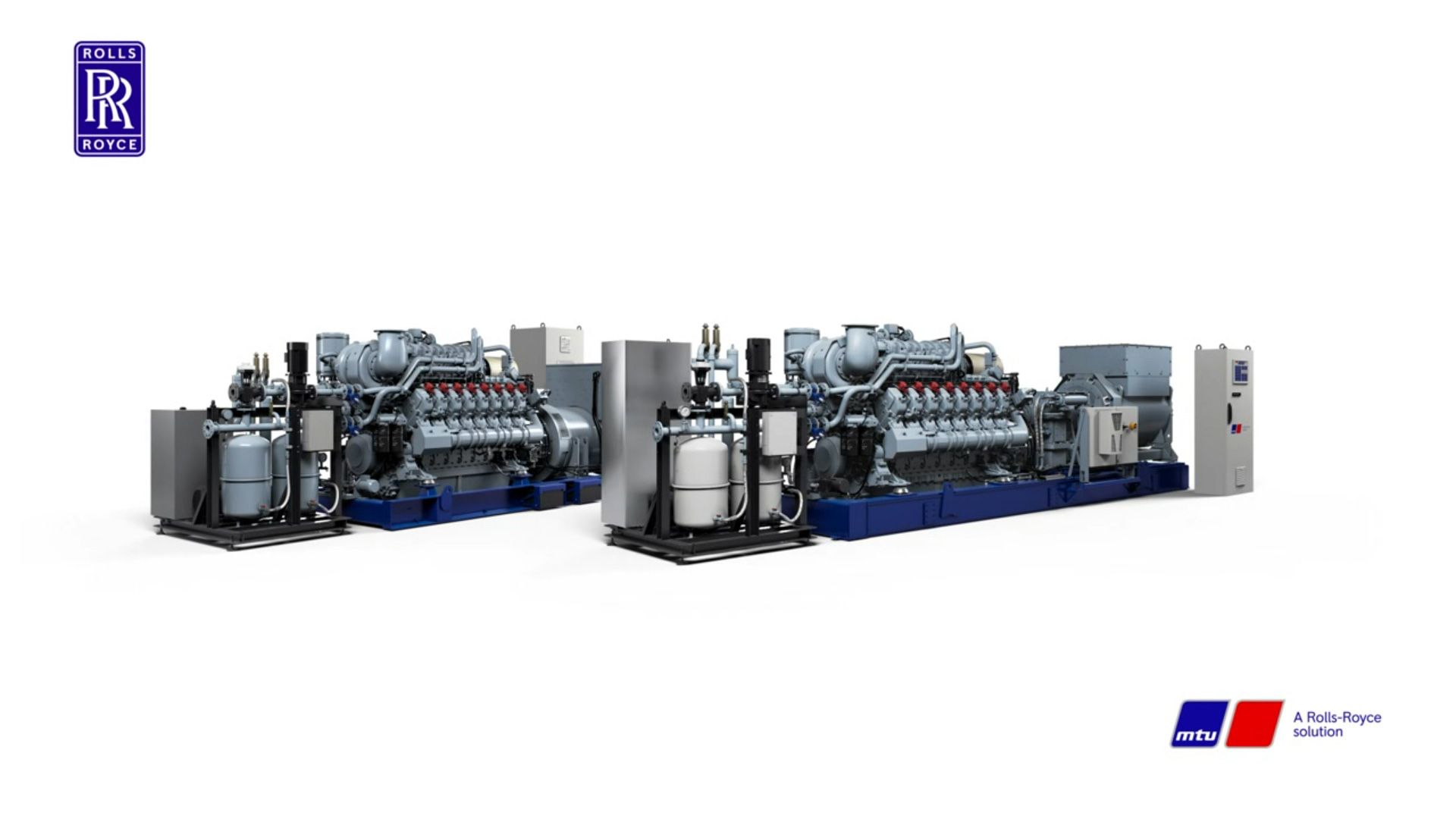

Eight mtu containerized gas gensets and four mtu L64 FNER gas engines have been supplied for a gas-fired power plant connected to an oil and gas production site in Oman.
Rolls-Royce completed the delivery of 12 generator sets (gensets) to a gas power plant servicing a large-scale oil and gas production site in Oman. The total supply consists of eight mtu containerized gas gensets and four mtu 20 V Series 4000 L64 FNER gas engines. Each genset produces 2 MW of power to meet the demands of the facility.

Gensets based on the L64 FNER gas engine offer a high-power density and reach efficiencies of up to 44.4%—an improvement in fuel/energy utilization at high temperatures when compared to its predecessor. Rolls-Royce’s mtu gas gensets can operate on a blend of natural gas and hydrogen and are optimized for high performance with low emissions. These units are compact and continuously provide 100% capacity power.
