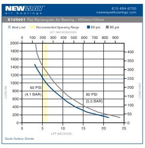

Fig 3.Lift-Load Chart for commercially available Externally Pressurized Porous[/caption]
The spring rate of a fluid film is primarily dependent on its film thickness- the thinner the gap the higher the stiffness. This is well known and documented in eccentricity ratios of hydrodynamic oil journal bearings, figure 1. Stiffness curves of dry gas seals, figure 2, and commercially available externally pressurized gas bearings, figure 3. Notice in every case that the stiffness is increasing exponentially at the smaller gaps.

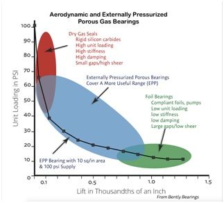

Fig 4. This is a “big picture” chart to conceptualize gas-bearing technology in turbo equipment. It is a lift vs. load chart for an externally pressurized porous (EPP) gas bearing that has 10 square inches of bearing face; 100 psi is fed to the bearing as the load on the bearing is increased. Resulting air gaps are shown on the bottom axis. The slope of the curve is representative of the film stiffness. The typical operating regions of dry gas seals and foil bearings are superimposed, as is the operating area for EPP Bearings. It can be seen that the EPP Bearings operate with a larger gap than dry gas seals, reducing heating and contact issues but still having good stiffness, damping and speed capabilities.[/caption]
It is hard for some to imagine how an air film could be too stiff in a structural loop made of metal but this can easily be the case. Stiffness in externally pressurized bearing is a function of pressure and load. Gas bearings with film stiffness of 10 million lb./in for heavily loaded applications are commercially available from stock. The same bearing, without the load would have stiffness less than 1000 lb./in. This effect can be seen in the lift load plot in Figure 4. At large gaps, above 0.0005in, the curve is near horizontal, which would be zero stiffness; at small gaps the curve is near vertical, which would be infinite stiffness.

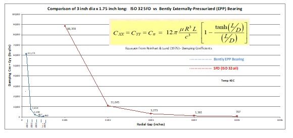

Our next topic, damping is certainly affected by stiffness. Damping, the property of dissipating energy is force/velocity, here in units of lb-s/in. We see in the eccentricity ratios that stiffness and damping are both increasing together as the rotor moves towards the bearing wall. As a way of conceptualizing this, it can help to think of damping in extremes of stiffness as noted above; if there is zero stiffness, there can be no damping because the rotor has nothing to exert force on. It is like ringing a rotor hanging on surgical tubing to get its undamped natural frequency.  If the stiffness is infinite, then there is no motion, and again zero damping(damping being force over velocity).So, for a given system and frequency, somewhere in between zero and infinite stiffness an optimum point will be reached to maximize the damping, after which point further increases in stiffness will begin to lock up the motion, reducing effective damping.
Hydrodynamic oil bearings are considered to have good damping properties. We can see in the eccentricity plot that damping increases with the stiffness but please remember that damping will be variable in a non-linear way, based on speed and temperature for the same reasons that the stiffness was.
Hydrostatic oil bearings offer a method to adjust the damping of oil bearings, again by having control over the film thickness via the external pressure.
Regarding aerodynamic bearings, it is frequently noted in turbo-related articles and papers that gas bearings have little stiffness and damping. This is experienced because the fluid film gaps referenced are larger than 0.0005 in and do not have enough stiffness to give damping, but the turbo industries are not used to having fluid film gaps in bearings even this thin.  Yet there seems  to be universal acknowledgement that aerodynamic bearings in dry gas seal applications have very small gaps < 0.0002in. and very high stiffness, as seen in figure 2.Again though, there is no ability to adjust the film thickness;you just take what you get.
Fig 5. Comparison of oil and air based squeeze film dampers. Air damping is similar to oil at 10 times smaller gaps.[/caption]
Aerostatic bearings do allow for the adjustability of stiffness in order to maximize the damping as noted above. There are equations for calculating the damping in fluid films. Using one that is often cited in the industry, we calculated the damping from an oil squeeze film damper at 5 different film thicknesses from 0.001 to 0.005 in. Again we see the same effect where damping increases exponentially at the smaller film thicknesses. Using the same equation, changing only the oil viscosity for that of air, and calculating the damping at 5 film thickness exactly 10 times smaller than with the oil(0.0001 to 0.0005 in.)we notice that the damping values are only marginal less than the oil, figure 5.

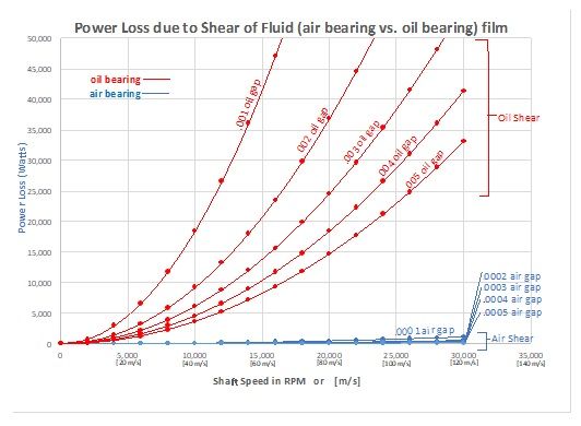

Cross coupled stiffness coefficients in rotordynamic calculations are away to account for the destabilizing effects of friction in the fluid film. With oil hydrodynamic journal bearings, and to a lesser degree in oil hydrodynamic tilt pads, as the rotation of the rotor drags oil underneath it, there is an equal force on the rotor causing it to climb up the side of the bearing wall. At first thought it may be hard to see how this could have much effect, but consider it this way, a 50 MW turbine losing 1% of its power to oil shear will require about half a megawatt of cooling service. This shear is the measure of the “traction” the rotor gets in the bearing. Half a megawatt is almost 700 HP,similar to when you see a 700 HP drag race car burning rubber and looking for traction at the start of a race. When considering that this is the same amount of traction the rotor has in the journal bearings, it is easier to conceptualize the destabilizing effects of friction. This friction may be seen graphically in figure 6.
Fig 6. Comparison of shear power losses between oil and air within their operating range. These losses are from the traction the rotor gets in the oil and responsible for the destabilizing cross-coupled stiffness terms.[/caption]
Considering a journal bearing of the same dimensions used in the damping example figure 5, but in figure 6,we solve for shear (at power loss) at speed. It is a representation of the “traction” we were referring previously, to and it becomes clear again that the thickness of the film is key. We have seen that stiffness, damping and now the destabilizing effects of shear are a cubed function of the film thickness. At smaller gaps where dynamic bearings operate, multiple rotordynamic properties are near asymptotic, with both heat generation and the destabilizing cross coupling changing dramatically with small changes in other properties.
Oil hydrostatic bearings would be more deterministic again in that it is possible to control the film thickness and so the other rotordynamic properties.
Aerodynamic journal bearings like leaf, bump or metal mesh type generate lift from the same principle as the oil hydrodynamic bearings. The viscosity of air is so low though, that it is difficult for the rotor to create a destabilizing cross coupled stiffness. This is also the fundamental reason the unit load capability of aerodynamic bearings is low.
Externally pressurized gas bearings, or aerostatic bearings, are also represented in figure 6. It is evident from the nearly zero power loss that there must be near zero cross couple stiffness. Dr. San Andres from Texas A&M Turbo Lab investigated this in a 2014 STLE (Society of Tribology Lube Engineers) paper on aerostatic bearings. He noted “External gas pressure has a large effect on the system damping ratio, increasing as supply pressure decreases and yet the complete absence of cross couple stiffness was remarkable”. Notice that Dr. San Andres’s findings regarding the damping increasing with decreasing supply pressure seems counter intuitive. The key is, by reducing the supply pressure the fluid film thickness is reduced and so its stiffness increases to allow more damping, yet still there was not 100 W of shear.
