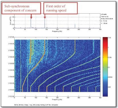

Figure 2: Compressor drive end proximity probe showing a sub-synchronous trace around 77 Hz appearED around 21:55 as the compressor speed increased. At 21:56, the compressor speed was 8500 rpm[/caption]

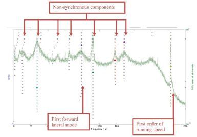

Figure 1: Power spectral density (green) and stability diagram (dots) from the centrifugal compressor when operating at approximately 11,000 rpm. The dots represent the stable points at which potential modes are as well as harmonics and non-synchronous components have been determined.[/caption]

The outcome of OMA is a power spectral density together with a stability diagram (Figure 1). The stability diagram establishes stable frequency points based on criteria determined by the analyst. Such criteria include variation in percentage of natural frequencies, damping and so on in the modal parameters extracted from a set of system orders.
These points are either natural frequencies or measured harmonics, such as the operating speed of the rotor (or adjacent machinery). OMA therefore requires expertise and experience in machinery dynamics to interpret the results and determine the natural frequencies.

During commissioning, the compressor revealed traces of what was suggested to be rotordynamic instability (Figure 2). The compressor increased speed from approximately 2,280 rpm to 8,500 rpm and a subsynchronous component appeared at about 21:55 (Figure 1). When the compressor was operating at 8,500 rpm (after 21:56) the subsynchronous component was centered at about 77 Hz and was larger than the first order vibration component.
The sub-synchronous component appeared to have a relatively sudden appearance during the increase in operating speed, and coincidences of changes in other process parameters were investigated at the time of onset. The discharge pressure increased relatively rapidly during increasing speed as would be expected, but no abnormal features were noted. The subsynchronous frequency was close to both the OEM and third-party rotordynamic predictions of the first lateral bending mode.
OMA was applied to the data collected during commissioning. The input to OMA was the data recorded from the compressor’s four radial proximity probes. Figure 1 shows the result at 11,000 rpm. The running speed of the rotor was known from the key phasor measurement and can therefore be identified as not being a mode. However the distinction of the other non-synchronous components seen in Figure 1 as being modes or forced excitation sources is not possible from just a single stability diagram.
The sub-synchronous trace at 77 Hz at 8500 rpm (21:56) in Figure 2 was tracked with OMA and its deflection shape was reasonable for a first bending mode. However, when the speed increased to 11,000 rpm, the deflection shape ( Figure 4) showed a difference in the relative phase of the whirl between the DE and the NDE side. Further, the sub-synchronous frequency had increased from 77 Hz @ 8500 rpm to 92 Hz @ 11,000 rpm which is larger than would be expected for a first forward bending mode. It was therefore considered that this was a subsynchronous forced excitation component and not the first forward lateral mode.
It should be noted that the actual first bending mode of the same rotor was also identified using OMA which conformed with estimations from both OEM and thirdparty rotordynamic calculations.
