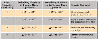

As reliability has a large effect on plant safety, end users should perform a hazard and operability (HAZOP) study—a structured analysis that evaluates the safety integrity level (SIL) of risk associated with existing operations. SILs, as defined by industry standards organizations, (IEC 61508, IEC 61511 and ANSI/ISA 84.01) estimate the probability of equipment failure on both demand and continuous operation. They range from SIL 1, which calls for minor property and production protection, to SIL 4, which requires catastrophic community protection (See Table 1 from the ARC Advisory Group.)
Table 1: Safety Integrity Levels[/caption]
