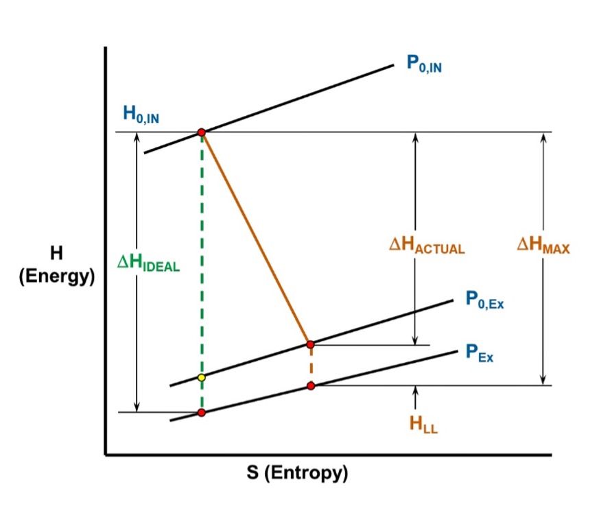

The core function of steam turbines is to convert thermal energy into mechanical work. Figure 1 shows the expansion process in a turbine on an Enthalpy-Entropy (H-S) chart. Steam enters the turbine inlet flange at high pressure (PO,IN) and total enthalpy (HO,IN). It expands to the exit static pressure (PEx) at the exhaust flange. The isentropic energy drop is DHIsen for lossless fluid expansion to PEx.As steam expands, the maximum amount of energy available for conversion to mechanical work (DHMax) decreases due to losses in the bladed flow path, as well as the flow components external to the bladed flow path, such as the trip and throttle valve, steam chest, governor valves, etc. Once actual work (DHActual) is extracted in the process, residual energy at the turbine exit is termed the leaving loss (HLL).
The maximum energy available, the actual work, and the leaving loss are related as shown in Equation 1. The leaving loss is proportional to the square of the velocity exiting the turbine, as shown in Equation 2. The overall turbine efficiency (η), as given in Equation 3, decreases due to the reduction in actual work as the leaving loss increases.
DHMax = DHActual + HLL (Eq. 1)
HLL = HO, Ex - HEx = (VEx2)/(2gcJ) (Eq. 2)
η = DHActual / DHIdeal (Eq. 3)

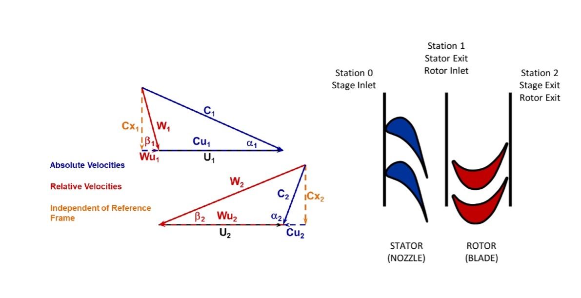

A turbine stage consists of a stator and a rotor. The stator is the stationary row that converts potential energy to kinetic energy. The rotor is the rotating row that extracts energy from the working fluid. The working fluid pressure drops across the stator, while it can drop or stay constant across the rotor. Velocity triangles help designers visualize how fluid moves through the turbine stage by illustrating the direction of flow and how it changes as it passes through the turbine stages. They represent the absolute velocity of the fluid, the relative velocity of the fluid in relation to the rotor, and the velocity of the rotor itself. Analyses of these velocity relationships gives engineers the information they need to:

Figure 2 illustrates a pressure-compounded axial turbine stage and velocity triangles. The three locations at which fluid properties and flow velocities are defined are Station 0, Station 1, and Station 2. Station 0 is at the inlet to the stage. Station 1 is common to the stator exit and the rotor inlet. Station 2 is at the rotor and stage exit. The velocity triangles at Station 1 and Station 2 are also shown where:
Absolute velocity, ft/sec (m/sec)
Blade speed at the mean diameter, ft/sec (m/sec)
Relative velocity, ft/sec (m/sec)
Axial component of the absolute velocity, ft/sec (m/sec)
Tangential component of the absolute velocity, ft/sec (m/sec)
Tangential component of the relative velocity, ft/sec (m/sec)
Flow angle of the absolute velocity vector w.r.t the tangential direction, °
Flow angle of the relative velocity vector w.r.t the tangential direction, °

The Euler Work Equation (Equation 4) relates the work extracted in a turbine stage to the stage velocity triangles. The work, or the heat drop, in an axial turbine is equal to the change in the angular momentum across the rotor. Assuming no change in the mean diameter (U1 = U2) across the rotor simplifies the Euler equation to the form shown in Equation 5, where the work is proportional to the change in the tangential component of the absolute velocity.
DHo = U1Cu1 – U2Cu2 (Eq. 4)
DHo = UDCu (Eq. 5)
where U = blade speed at the mean diameter
Cu = absolute frame velocity

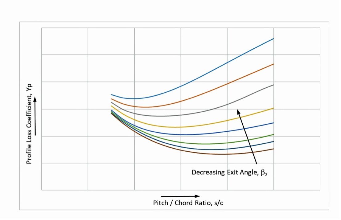

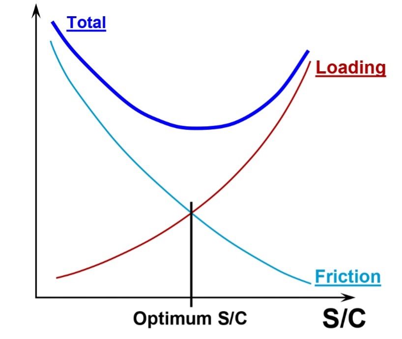

Profile loss is related to the shape and characteristics of the turbine blades or vanes and occurs due to friction at the airfoil surface, the cascade loading, and, to a smaller extent, the geometry features such as maximum thickness, trailing edge thickness, etc.
The profile loss is a function of the pitch-to-chord ratio (s/c), the turning angle, and the incidence. The variation of the base profile loss coefficient, Yp, as a function of the s/c ratio and the bucket exit angle is shown in Figure 3. An increase in the airfoil count causes an increase in the frictional losses and a corresponding reduction in the loading losses. Reducing the airfoil count has the opposite effect, where the loading loss increases while the frictional losses decrease. The minimum total pressure loss occurs at s/c values where the combined losses due to friction and loading are at a minimum (Figure 4).

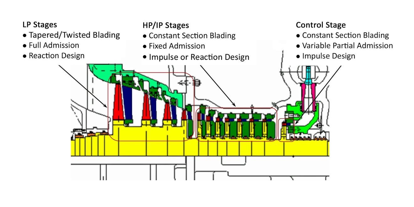

A typical, straight-through, condensing mechanical drive turbine flow path consists of three distinct sections (Figure 5). These are the inlet (control stage), the group (HP/IP) stages, and the low-pressure (LP) stages. The mean diameter of each of these sections is defined separately in the design. The mean diameter of the inlet stage and the low-pressure stages depend on the casings selected. Both the steam end and the exhaust end are selected based on the maximum volumetric flow rate requirements and the pressure and temperature ratings of the casings. The rotation speed of mechanical drive turbines is typically determined by the driven equipment.
Inlet Stage
The inlet (control) stage is typically an impulse design that operates under conditions of partial admission to meet the varying load requirements and manage the variations in the volumetric flow rate. It is generally the least efficient stage in the flow path for the following reasons:

The low-pressure (LP) end of condensing turbines is designed by reapplying a predesigned grouping of matched stages. The predesigned LP end is also typically matched to individual exhaust ends in the inventory. Optimizing the selected LP end to specific project requirements includes minimizing the leaving loss, adjusting the height of and rotating individual stator and rotor rows to minimize row incidence. The leaving loss can be minimized by ensuring a large enough annulus area, which is a function of the rotor hub and tip diameters exiting the last stage blade.
Group Stages
Designers have the most flexibility when defining the mean diameter flow path of the group stages, including the blending of the mean diameter with the downstream low-pressure stages. The efficiency of the group stages as a whole is primarily a function of the stage count and the stage reaction. The stage count increases with the stage reaction.
