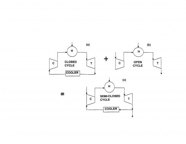

With its exhaust to the atmosphere and straightforward design, its manufacture and operation more trouble free, an open cycle gas turbine (Figure 1) is more cost effective, both for capital costs and operation expenses, than a steam power plant. However, it will not match the superior thermal efficiency of a CCGT.
Figure 1: A semi-closed cycle gas turbine is the combination of a closed and open cycle gas turbine. (From Advanced Gas Turbine Cycles, by J. H. Horlock, Pergamon, 2003)

To understand Wettstein’s supercharger analysis, consider again a closed cycle gas turbine (Figure 1) where a working fluid (air, but it could be helium, and so on.) is recirculating without any internal combustion. Approximating a thermodynamic Brayton cycle, the closed cycle gas turbine has two heat exchangers, one for rejecting heat from working fluid entering the compressor and one for energy addition to flow entering the turbine. The latter is heated by an external energy source, such as combustion, a solar collector or a nuclear reactor. Some 24 closed cycle electrical power plants were installed, mostly in Europe, from 1940 into the 1980s.

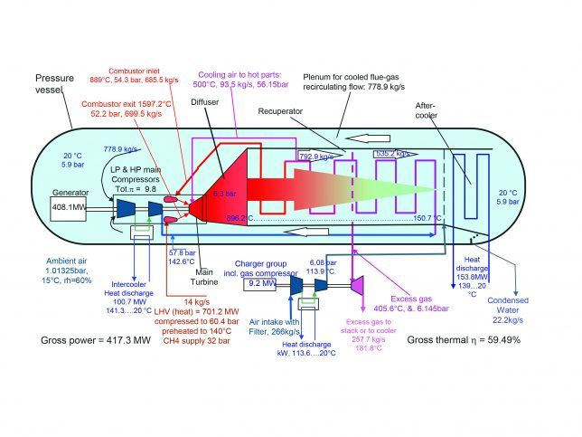

Figure 2. Supercharged semi-closed cycle gas turbine power plant. Courtesy of Hans Wettstein

The supercharged gas turbine power plant proposed by Wettstein is a semi-closed (SC) cycle (Figure 2). The SC cycle is an amalgamation of closed and open cycles. It consists of a GT having an internal combustor for energy input to the cycle.
Part of the exhaust is rejected to the atmosphere, with the remainder recirculated into the compressor. Atmospheric air is also introduced into the compressor to maintain a desired mass flow rate and provide makeup oxygen to sustain combustion.
One can go through a simple illustration to show that given similar conditions for both open and closed cycles, a semi-closed cycle should have approximately the same efficiency as either. However, with an SC cycle, a designer now has some of the best features of both open and closed to move SC power plant operation in different directions.
With internal combustion, the SC cycle is not constrained by the temperature limitations of the closed cycle. Also, the SC cycle will have the favorable part load efficiencies of the closed cycle if pressure levels can be varied. Wettstein introduces a supercharger to the SC cycle. He also includes cycle study thermodynamic data at appropriate points. If one carefully follows these, a picture emerges of SC cycle details.
This SC unit is enclosed within a common pressure vessel at a relatively moderate pressure of 5.9/bar (86 psia or 5.8 atm). Starting at the low compressor inlet, gas is introduced at 20°C and 5.9 bar from the surrounding pressure vessel. Since this is a SC cycle, the gas mass flow consists of a cool turbine exhaust (66%) and supercharger provided air (34%), with a ratio of exhaust-to-fresh air of 2:1. Gas path flow then passes through the low compressor through an intercooler and into the high compressor for a total compression ratio of 9.8:1. High compressor exiting gas flow then enters the recuperator.
It is preheated by turbine exhaust gas before it enters the combustor where combustion takes place with natural gas as the fuel. From the combustor, hot gases enter the turbine which drives the compressor and the 400 MW electrical generator. The resulting exhaust gases enter the recuperator to preheat the compressor flow before it enters the combustor. At some point in the recuperator, exhaust gases are withdrawn to power the turbine of the supercharger. This exhaust gas portion can be discharged up the exhaust stack.
This turbine powers the supercharger compressor which supplies fresh air to the SC cycle, and just as important, controls the pressure level in the common pressure vessel. Finally, as exhaust gases exit the recuperator, they mix with fresh supercharger air.
As required by Second Law of Thermodynamics, the mixed exhaust gases are cooled (heat rejection from the cycle) by a heat exchanger to remove combustion-produced water vapor and to lower the temperature of the inlet gas turbine compressor flow to the specified 20°C.
Promising concept
Wettstein’s design study for this supercharged semi-closed gas turbine cycle shows great promise. At an output 417 MW, the calculated thermal efficiency is 60%. As pressure levels can be varied, part load output can be controlled independent of turbine inlet temperature. This design would take advantage of existing GT components.
