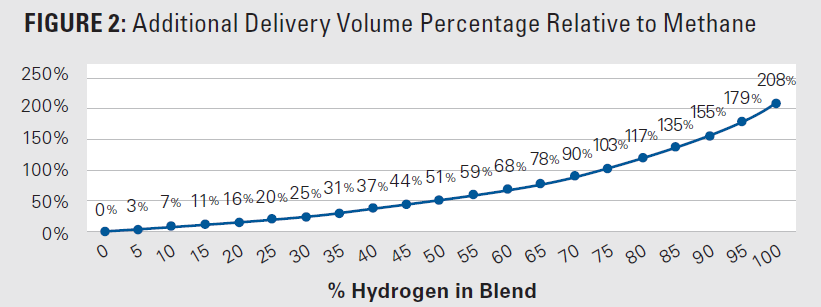

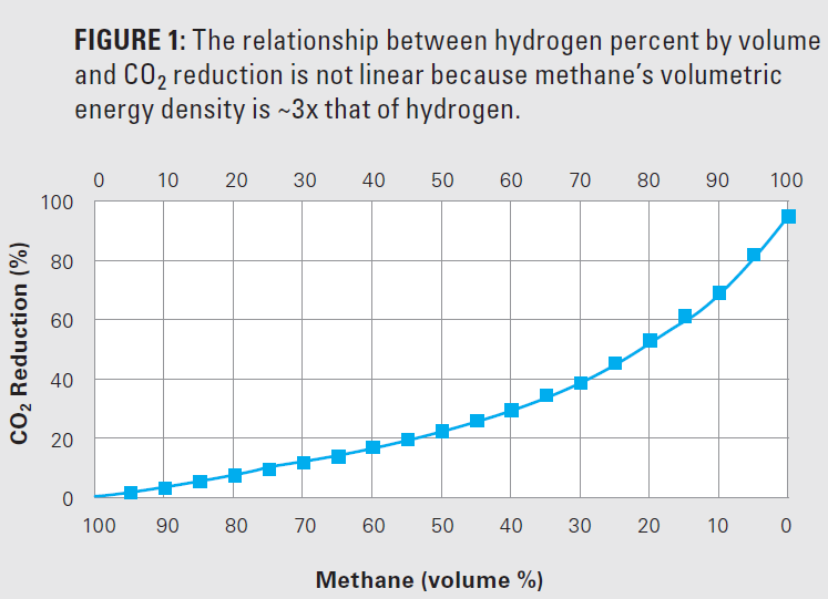

When using hydrogen in conjunction with natural gas or as a full replacement, it is important to understand how the two fuels differ. A 100% hydrogen blend requires 208% of additional volumetric flow, roughly three times compared to methane. A 75% blend of hydrogen is required to reduce CO2 emissions by 50%. These percentages make the immediate plug-and-play use of hydrogen in gas turbines difficult.

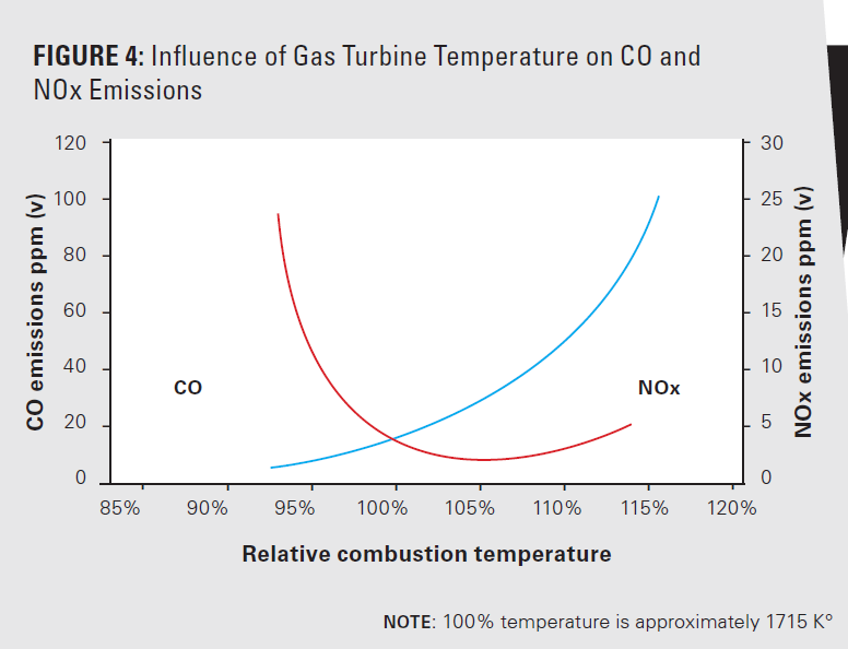

Due to NOx challenges in diffusion combustors, many of today’s new gas turbine designs are equipped with lean premixed combustion systems: dry low emissions (DLE) and dry low NOx (DLN) combustors. “Dry” indicates that no diluents, such as steam or water, are used for emissions control. While diffusion combustors are currently more capable of burning hydrogen, the gas turbine industry recognizes that lean premixed combustors, with superior emissions control, will continue to be the dominant combustion system for new designs, even with hydrogen.
The main difference between the lean premixed and diffusion combustors is that the fuel and air are mixed prior to injection into the combustion chamber in a lean premixed system. The homogeneous mixture of air and fuel allows for a uniform and lower temperature flame, reducing NOx emissions without the use of dilution and the associated efficiency penalty. Most modern lean premixed combustors also use fuel staging with lean fuel-air ratios to help further control emissions. Lean premixed systems can look vastly different between OEMs and even turbine designs. DLE technology has been continuously evolving, as there has been a constant push for higher efficiencies and lower emissions. The wide variety of designs translates to a large range of hydrogen-burning capabilities across turbines. But today, in almost all cases, lean premixed combustors can handle lower volume percentages of hydrogen when compared to diffusion combustors.

Since all the combustion takes place downstream of the compressor, the combustion of hydrogen does not have a direct impact on the compressor. There are a few indirect impacts that pertain to NOx abatement. There are two possible ways to minimize NOx emissions, either through unit derate or dilution (standard combustor). If unit derate is chosen, the off-design point selected must be acceptable for compressor performance and health. If additional dilution in standard combustors is chosen, the surge margin may be adversely impacted by the change in mass flow of the turbine section relative to the compressor section.
