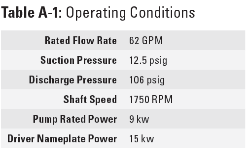

At a Saudi Aramco facility, two magnetic drive pumps (Unit A and Unit B) were installed in a sulfur-treating unit to transfer liquid sulfur to a pestillator. Both ran 100% in continuous operation. These pumps were crucial, and failure would lead to a shutdown of the sulfur-treating unit. Due to continuous failure of the pumps, the plant elected to purchase an identical unit, as a spare, to improve system availability. At one point, two pumps were out of service, and the spare pump was installed onsite. However, the spare produced abnormal sounds. Fears of operational instability prompted an investigation.
A mechanically sealed pump can be used with a high amount of hydrogen sulfide (H2S) and total suspended solids (TSS). If TSS is high, a magnetic drive pump isn’t recommended. Hydrodynamically sealed pumps should be used when the process requires constant runtime, without frequent stoppage and positive suction pressure. Such design uses an auxiliary impeller to act as a dynamic seal.
The molten sulfur pumps are magnetic drive centrifugal pumps with the following design parameters (Table A-1):

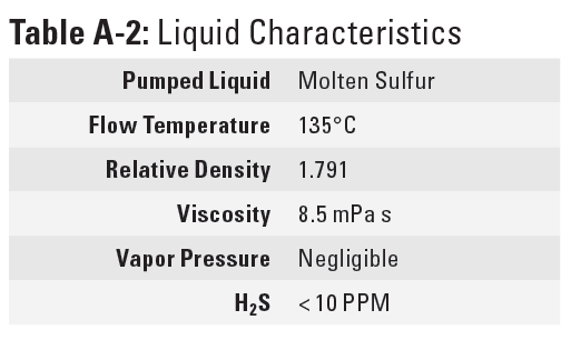

Table A-2 below summarizes the liquid characteristics.
Magnetic drive pumps contain heating areas in which the pumped liquid (sulfur) must be kept at a constant temperature to avoid solidification of sulfur and keep it in its liquid state.

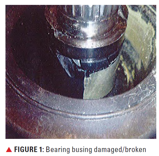

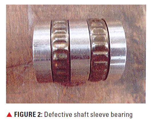

An extremely loud pump is an indication that the magnetic coupling is completely ruptured. After dismantling the pumps, several parts were shown to be damaged or broken. For Unit A, this included the bearing bushing (FIGURE 1), casing gasket, small pieces of the magnetic coupling ring, and the shaft sleeve bearing (FIGURE 2). High run-out was observed on both the top and pump shafts.

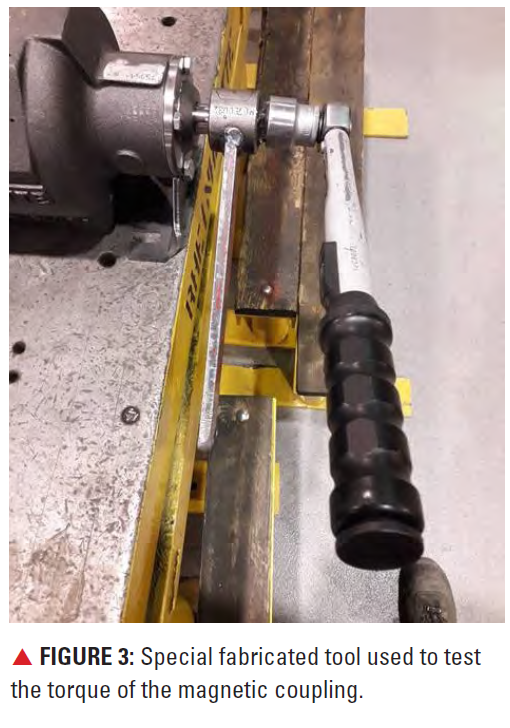

To test the integrity of the magnetic coupling, a special tool was fabricated for the drive shaft. Essentially, an M16 welding screw with an M24 nut (FIGURE 3).
On the lathe machine, the inner magnet was fixed to the lathe head while supporting the outer magnet on two lathe machine bearing holders. The special tool was mounted on the drive shaft until it reached the end of the thread. A torque-wrench placed on top of the special tool welded nut allowed adjustment to 99 N.m. They were to turn the wrench until the magnetic coupling moved or the wrench clicked.
For Unit A, the magnetic coupling slipped when the torque reached 35 N.m., indicating the magnet lost 60% of its strength. For Unit B, the torque test reached 99 N.m without any slippage, a positive result.
